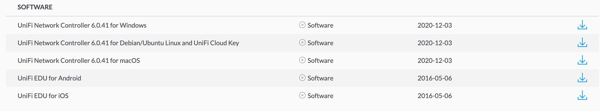

The one option I noticed missing from Acestes initial reply was the option to install Ubiquiti’s Unifi controller software directly on a Mac, Windows, or Linux machine. This will allow you to configure and manage devices until you decide what controller hardware you would like to use.
I started in Unifi using this method with a single UAP and it worked just fine, it is just not the best option for 24/7 monitoring.
Ubiquiti’s Unifi controller software can be downloaded from the below URL:
Hope this helps and have fun with the build!
