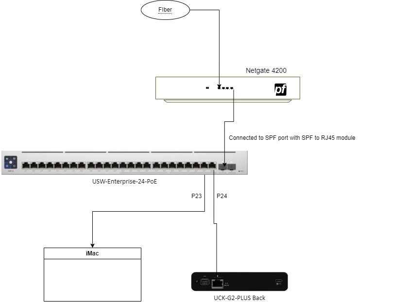

I think I already got the pfSense side built, basic settings, LAN and four VLANs and basic rules for VLANs, allow all Protocols out. The problem is that I can’t get to CloudKey at all. Its display shows the default fallback ip address (192.168.1.30). How should I start the configuration on the Unifi side so that I can have the Unifi Network formed and then adopt that switch? My iMac doesn’t even get an IP address because the Unifi network is missing, right? This is probably a simple thing but I just can’t seem to move forward with this. The attached picture shows how the devices are connected to each other. Most likely, this will raise questions and I will be happy to answer them all.

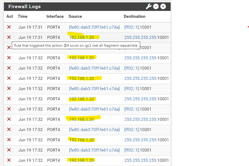

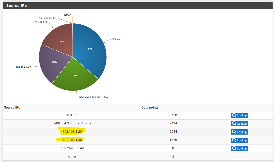

Firewall logs shows that 192.162.1.20 is blocked. That IP address shows on the little screen of the switch. Switch is connected to port 4 on Netgate. I thing that I saw earlier address 192.162.1.30 on that list too (fallback address of the CloudKey).
I would think that the necessary firewall rules have been made, but apparently something is missing. Can you tell from that log which settings should be changed?
192.168.1.20 is the default ip address if the device can not see the dhcp server on your network

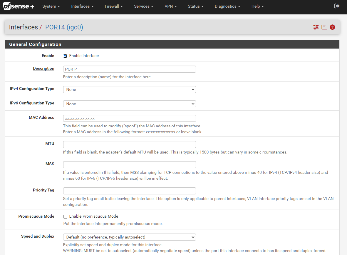

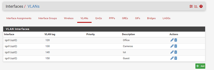

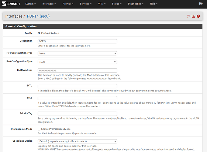

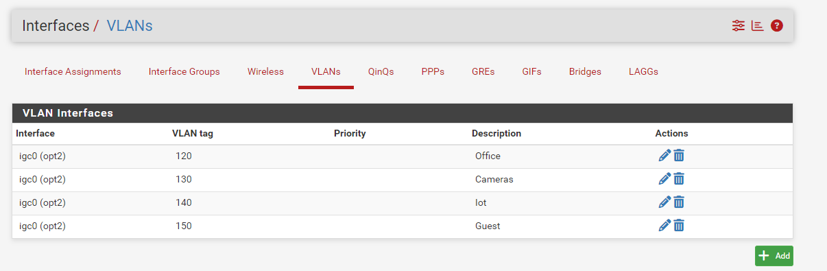

It is on (“Enable interface” checked). Yes I have created 4 VLANs and they go trough PORT 4.
Now I’m starting to see more clearly… it doesn’t have an IP address because I haven’t given it an address (IPv4 Configuration Type: none) and thus DHCP isn’t configured for it either. How primitive and simple can I be, yes, I’m such a beginner :confused:

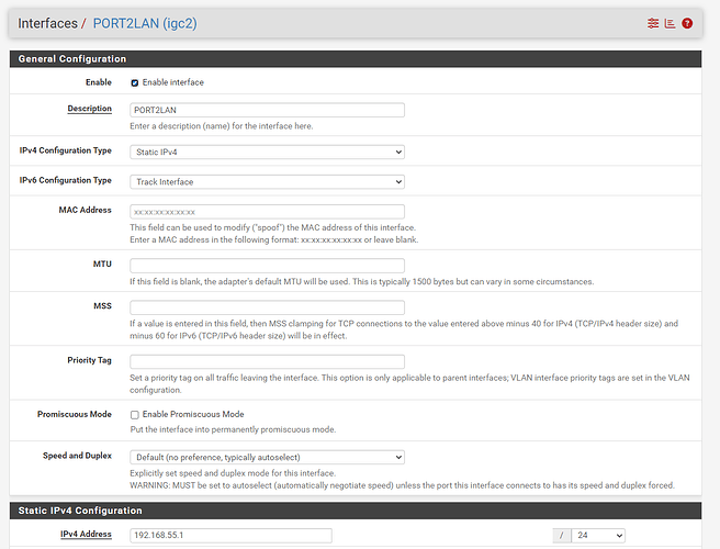

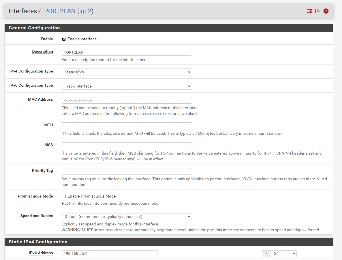

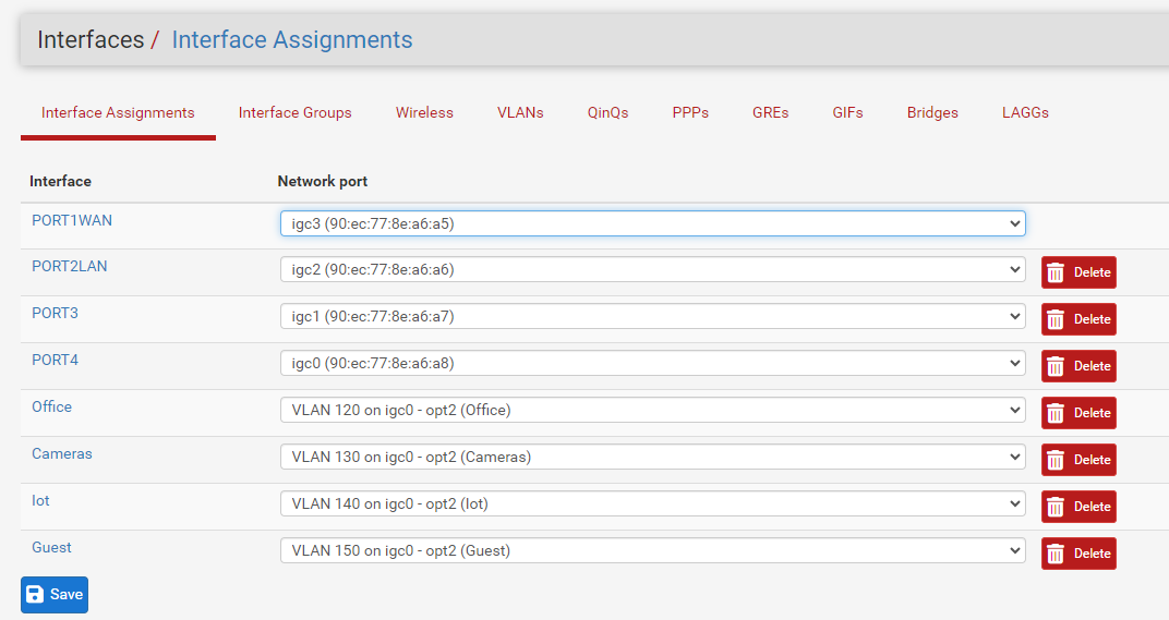

So it’s should be treated as another LAN? I guess I can’t give it the same address as the actual LAN port has?
So I should probably connect the switch to exactly that PORT2LAN port (port 2 is Netgate) and also direct the all VLANs to go through it, right, and forget PORT4 completely at this stage?

from the screenshot of port4 , you need to get it a ipv4 static ip address and configure dhcp on port4
Each port has to be configued as a totally seperate network - ports do not operate as a network switch
Is office going to be your main network, then you need delete the vlan setting 120 and configure port 4 with the same network settings
I connected the switch to Netgate port 2 (the actual LAN port) and also directed all VLANs to go through it. The switch, CloudKey and iMac immediately got IP addresses and I can connect to the CloudKey. Now the next thing is to set up the Unifi network and start adopting all Unifi access points and cameras and set up Wlains and set which devices I want to direct to which VLAN from the switch. I meant to leave all the network devices in the actual LAN, the computers in the Office VLAN, the Ubiquiti cameras in the CAM VLAN and the television and other similar ones in the IOT VLAN. For these VLANs, I probably still have to make firewall settings between each other, but I found at least one video where Tom shows an example of making such firewall rules.
