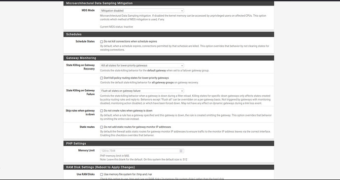

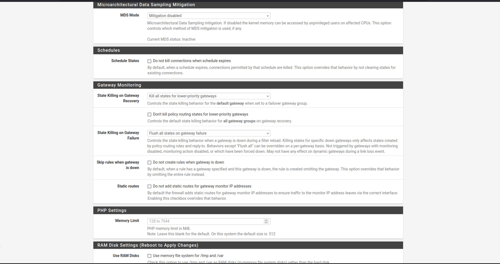

There was a power outage yesterday and ISP modem lost internet and came back. But after that devices are not able to go to internet. I also changed the setting of Flush states. All the VLANS are set correctly everything is set properly. Only issue, I am facing is some devices are not getting IP addresses and some of them are getting IP’s but not able to see internet.However some of them are working fine. I am confused what to do. I had already deployed it at site and now having this kind of weird issues.

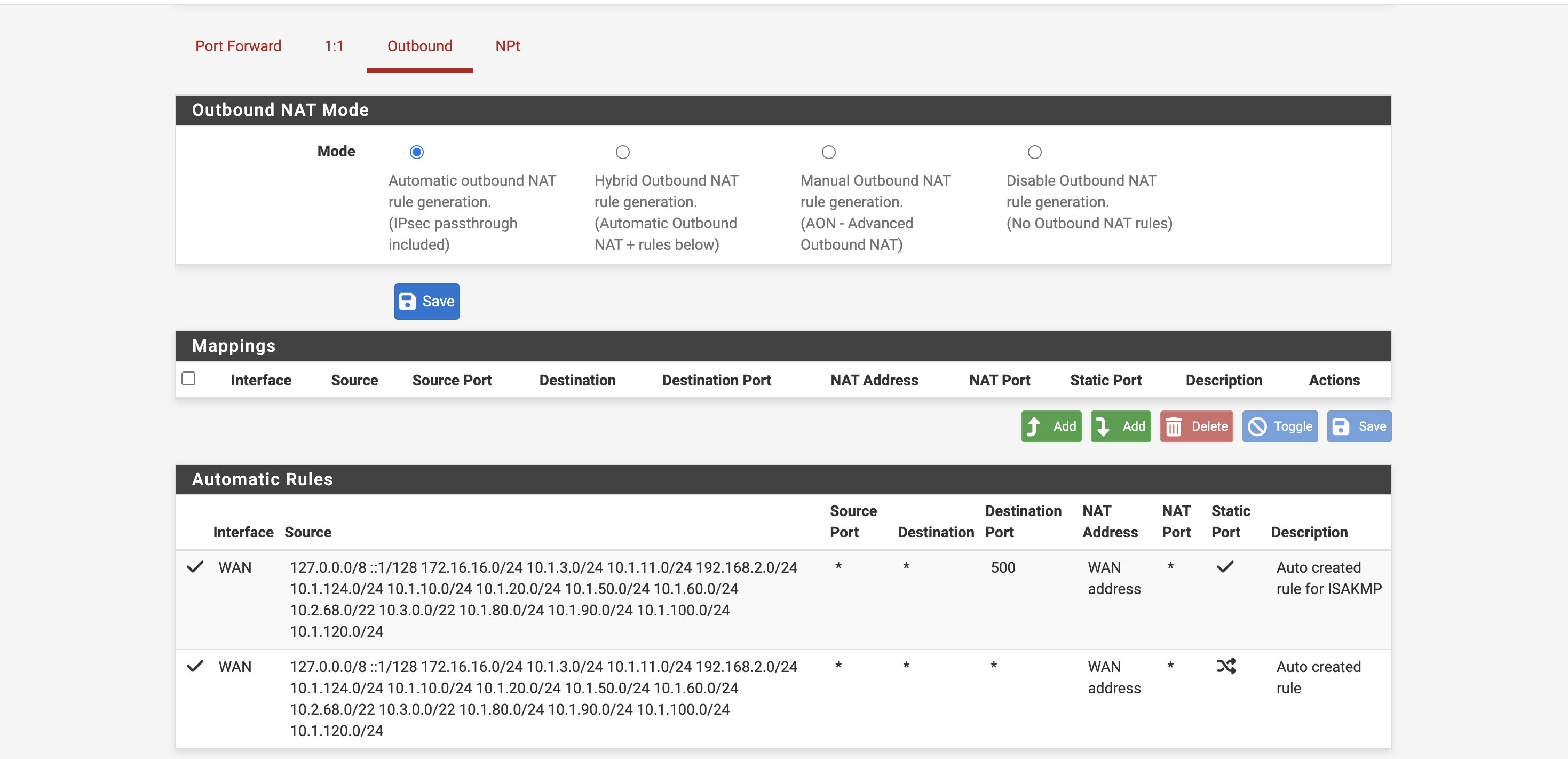

I did it. Now everything is getting IP’s. One more issue I found out is, one of my VLAN’s are not getting internet. Maybe because of Outbound NAT issue. Can someone also suggest what to do for that.
Right now NAT is on AUTOMATIC. screenshot is attached.

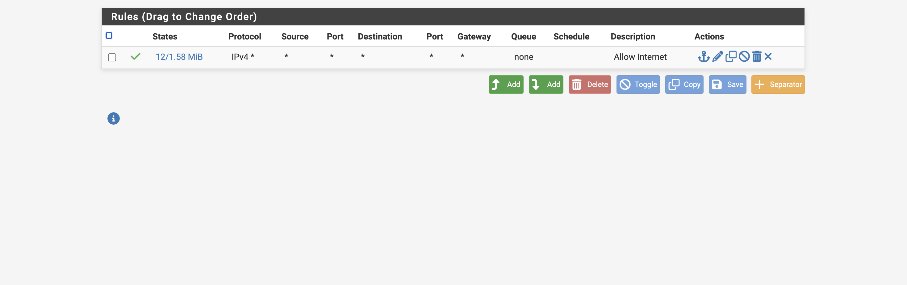

Only my IOT VLAN is unable to go to internet.
Firewall rule screenshot :
