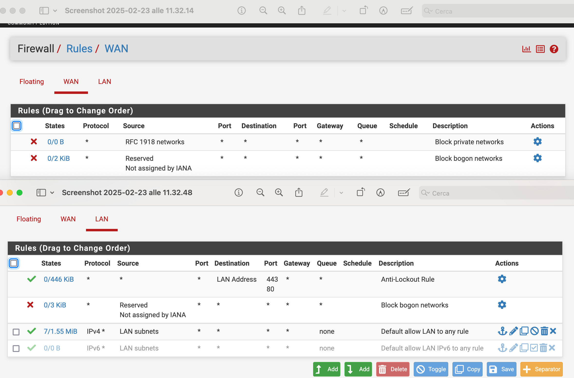

to do the tests, I created a virtual pfsense connected to the primary pfsense like so.
the vlan 240 on the first, has completely access to internet and blocks other vlan access.
Other vlans cannot access to vlan 240.
I am not an expert so maybe this is the cause, but I don’t know why it crashes the network.

here I have no special rules, just basic and no floating
