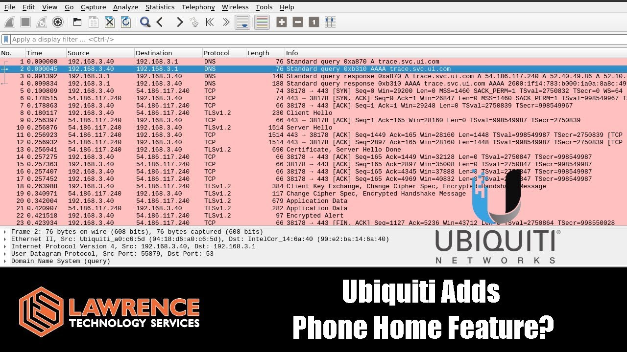

After an update of my pi-hole, running on a raspberry pi, the pi-hile blocked a service "trace.svc.ui.com’, I’m not sure it is the source of the issue, but since then I noticed the problem.

UniFi does that as part of their stats collection system.
Ok, so that is not the cause
