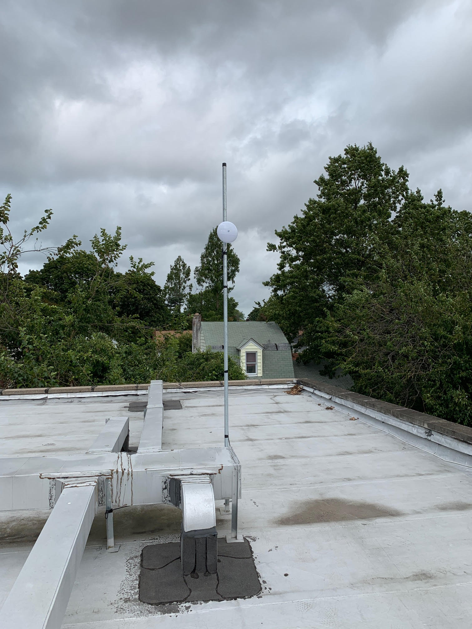

thanks, I ended up just installing them and they worked perfectly fine. 655Mbps on each antenna. I figured since they’re both apparently EU or whatever (non us) as long as they are the same it’ll work fine. Attached some pictures cuz these things are just so cooooooll love them.
