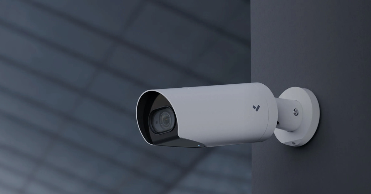

That was one of the companies I came across in my search for cloud solutions. Verkada and Rhombus were the other two seeming large players. On paper they all look good, would be nice if I has hand on experience.

You might want to avoid those, or maybe you can get them at a really good deal right now…
