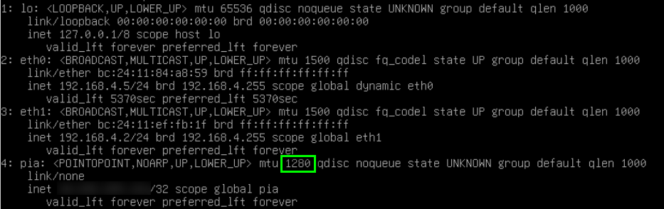

Troubleshooting a bit, I found out that I need to set up the MTU at the WireGuard interface to something lower (like 1280 in the pic below)
eth0 is the WAN interface, pia is the wg interface, eth1 is the LAN interface

You only need to set the lower MTU on the Wiegaurd connections, not on the switches or other devices.
Thank you. Based on what you said I went back and troubleshooted a little further, and it turns out iptables was misconfigured.
