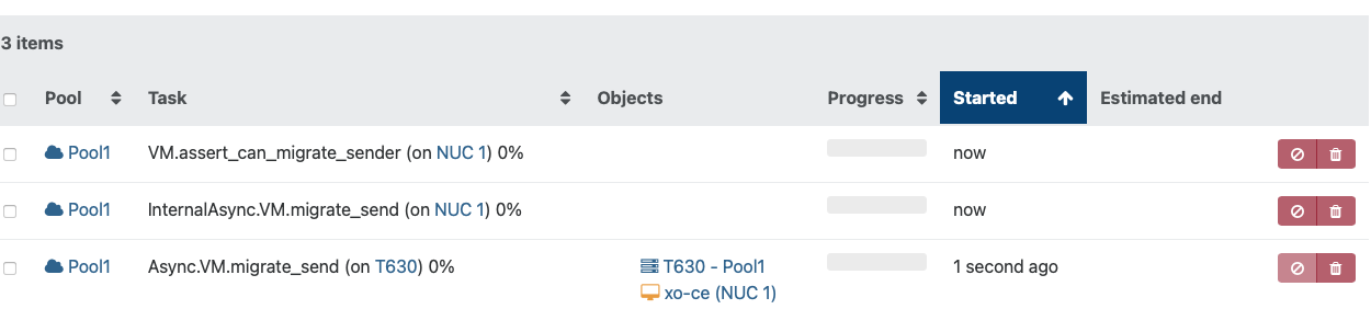

4 hosts on latest 8.2 each with internal storage
Synology DS418 shared storage via iSCSI
Try to migrate a vm from one host to any of the other hosts
In Tasks list several tasks appear and disappear very fast but migration never happens. The photo shows the tasks that appear

Thank you Greg, The T630 is a Dell PowerEdge T630 I am testing and learning with for xcp-ng. I have two older Intel NUC’s and a Datto I re-flashed to scp-ng. I am just testing and learning the xcp-ng echo-system. I have tried the other vm’s both warm migration and shutdown. They all act the same way, several tasks flash and disappear over and over and nothing happens.

For anyone that stumbles on this post, I found the issue. I had to do with CBT or snapshots. Maybe just snapshots but I found it in xensource.log file. This error showed up over and over. I deleted the snapshot on a vm and it migrated fine.
Async.VM.migrate_send R:75e6fb973e54 failed with exception Server_error(VDI_CBT_ENABLED
