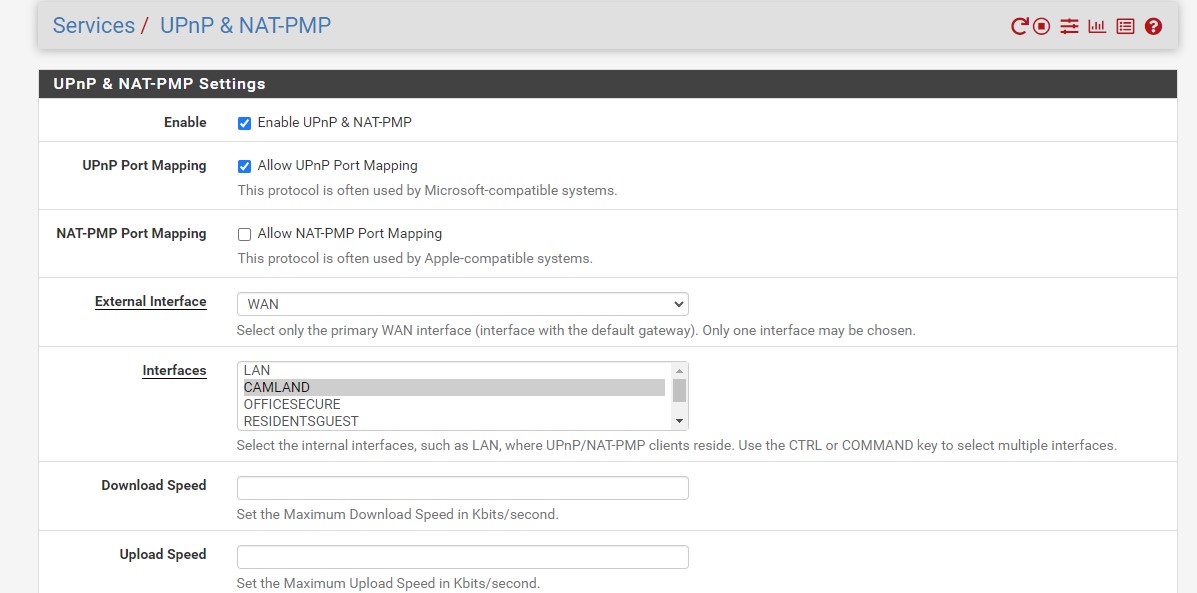

If it is working with a consumer router but not working with pfsense my guess would be that the consumer router has UPNP enabled by default as many do. You can turn that on in pfsense but it is off by default as it’s considered a security risk to allow devices to automatically open ports.
https://docs.netgate.com/pfsense/en/latest/services/upnp.html

I got the cameras to pull the correct IP address, enabling UPNP did not resolve the issue.
If anyone has any suggestions it would be much appreciated.
Here’s a SS of the upnp in case i did something wrong.
I also have tried opening ports 8000, 80, and 554
