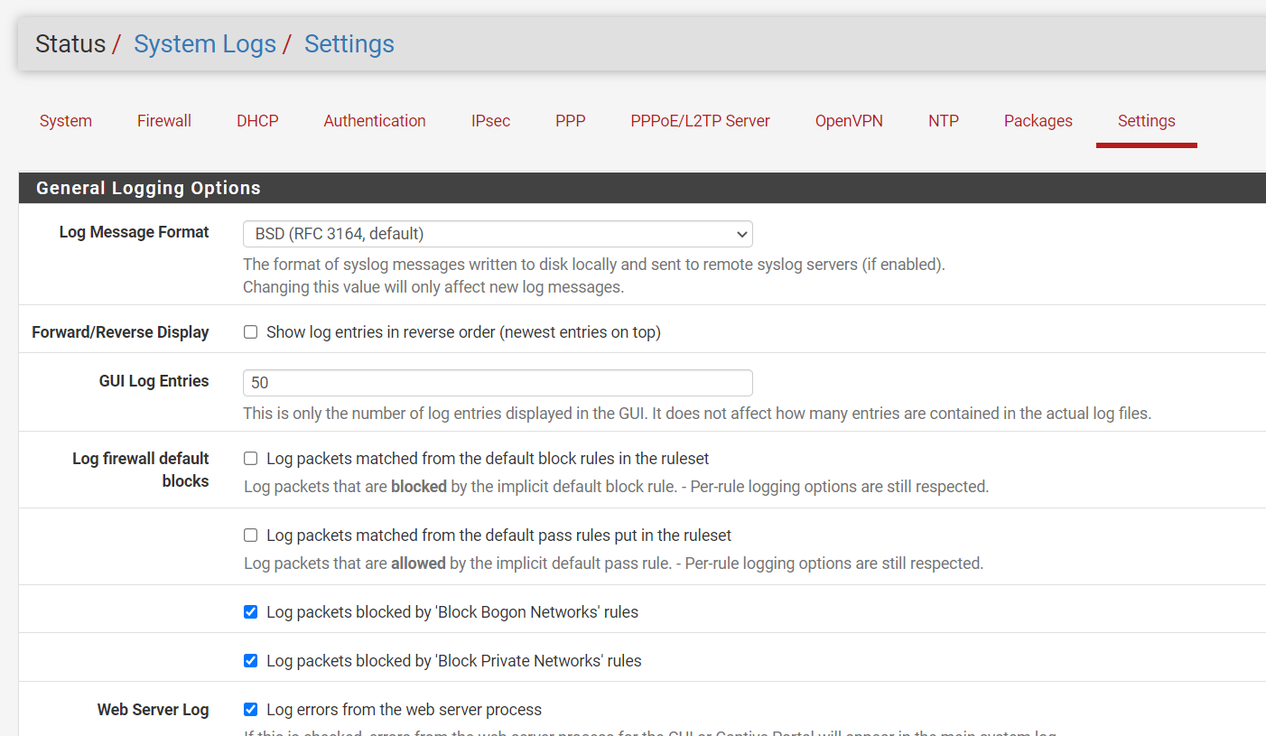

In pfSense in Status > system logs > settings you may want to take a look at the “Log firewall default blocks” section. I have the first two unchecked on mine, but those are match rules that make a lot of noise.
I unchecked the first two rules as you recommended a few days and havent had any block log entries since then. It does appear that nearly all of the traffic is internal and likely SLAAC related as you suggested. I hate to turn off logging, but the massive of amount of data wasn’t useful at all. I looked at a recent sample of 10,000 log entries, and it occurred in just over 6 minutes. Thank you for your assistance!
Glad I could help! The most important thing about logging is that the data generate is useful. If the haystack is so big you cant find the needle then the logs are worthless. Have a great day!
