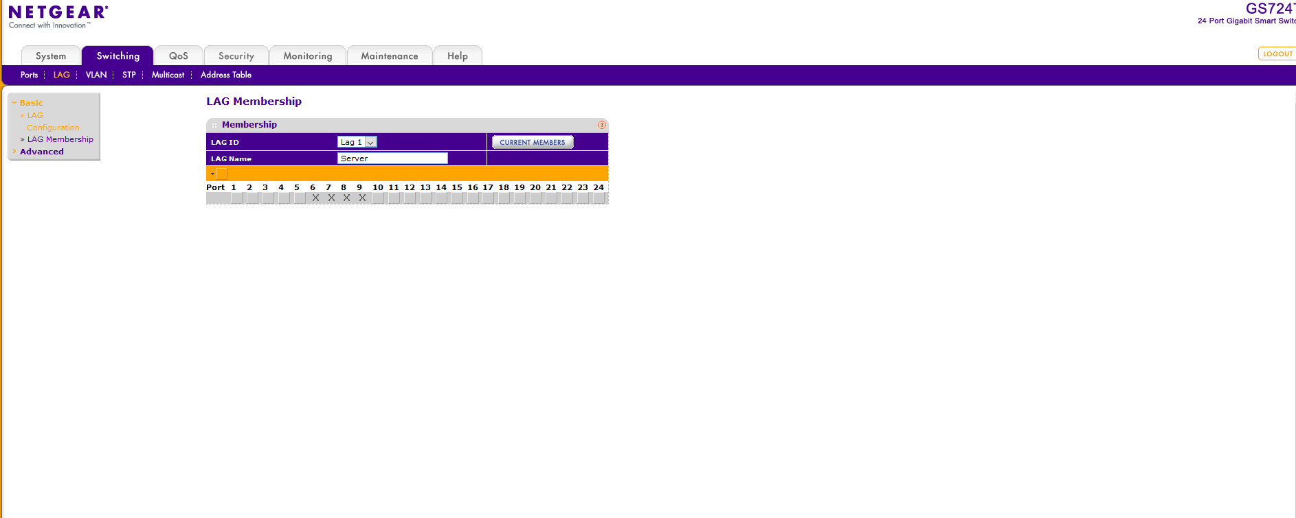

the switch is a netgear gs724t and to my knowledge supports LACP, the Lag is set to LACP and is showing as up. in vlan settings ive pointed the lag to vlan 50 and set PVID of the lag to 50.
