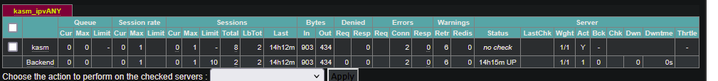

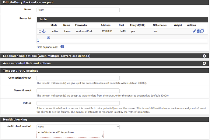

One simple place where these 503 errors happen is with HAProxy’s health checks. Have a look at the proxy’s stats page and see what your backend is doing. It’s likely failing an L7 health check. Very often just disabling that check will bring the host online. In the config file you’d just eliminate the word check from the kasm backend, but in pfSense, I think there’s some drop-down menu to adjust (also under the kasm backend).
Not a silver bullet, but it’s a simple first step to try.

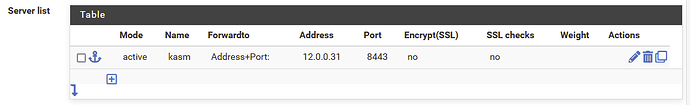

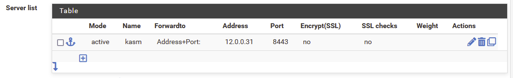

With it configured on Pfsense, I don’t have the health check marked:
Thank you for your suggestion but I don’t think that is the issue.

Here is the stats page:

Here’s a thought: 8443 is usually used for https connections, however, you have Encrypt (SSL) set to “no.” Change that to “yes” and see if it makes a difference. Leave SSL checks set to “no”; presumably Kasm would use a self-signed cert.
By the way, that SSL checks option isn’t the check I was talking about in my prior comment. There’s a healthcheck field somewhere below that table. But try the Encrypt field before worrying about that.
Tested, resulted in the same error 503. I was pretty sure Ecrypt needed to be off because Kasm provides its own cert.

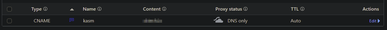

domain dns setup with cloudflare:
Content: my domain
Using pihole for DNS
nslookup to kasm.domain.com proxy results in my public address.

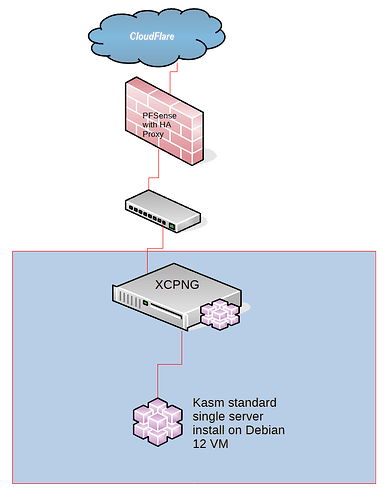

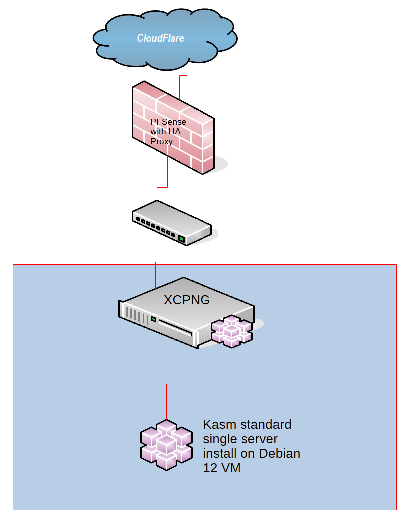

I’m not sure what your entire setup is like. Out of curiosity I stood up a kasm instance on a VM locally on my network and I had no issues using HAproxy. Maybe you missed a step somewhere. I noticed you are using port 8443. When I did the install it is using 443. I think for further assistance it would be nice to see a diagram of the networking, configs, and so on. There wouldn’t be any reason this shouldn’t work.
Below is a rough drawing of the infrastructure:
I originally did the install without using the flag -L to specify the port to 8443. Just a standard normal install. Reading through the proxy documentation it seemed like they were saying HAProxy operated on 443 so I should use something like 8443 for Kasm to listen on.
Please let me know if you need more information/explanation.

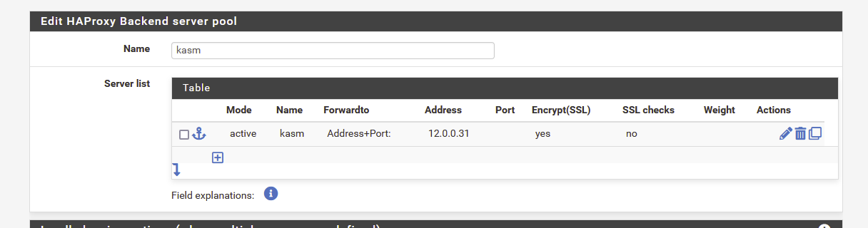

I redid the install for Kasm and am still getting the same error. So default port 443.
I also tried putting port 443 in the port textbox. Got a bad request (400).
