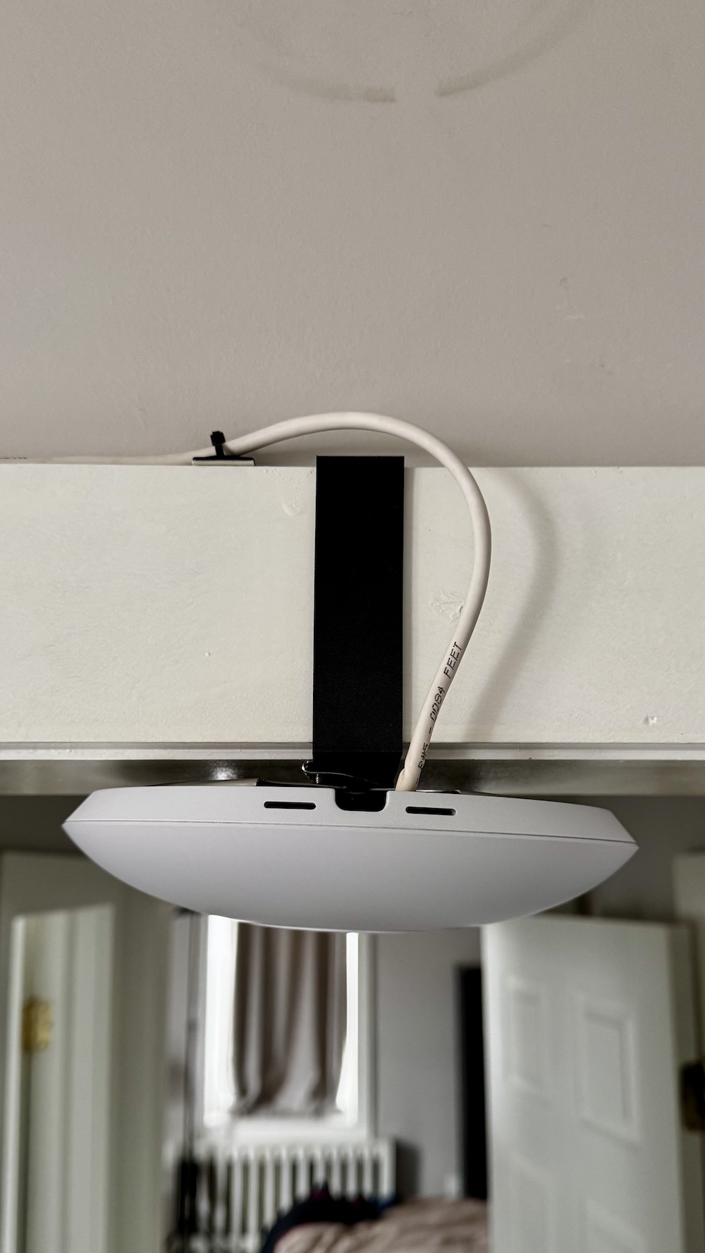

I can confirm that. I had my U7 Pro mounted on the wall (see the mark on the top of the image). My bedroom had 1-5 Mbits/s. It could be a metal beam there.
3D printed a new mount, so I can orient differently: 600 Mbits/s or more.
(Also having the 2.5 GbE cable almost doubled the speed.)
