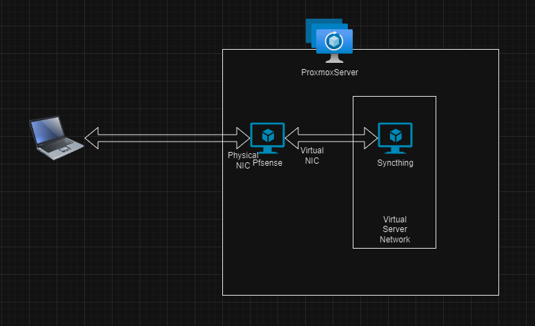

I decided to move my servers from all running on the main NIC of my Proxmox server, to run on a virtual network, behind a pfsense router.
(bad drawing attached bellow)
When i have the server behind the Pfsense router, it seems that the connection keeps dropping for some reason.
But i can SSH to the server without any issues. which is also routed via the pfsense. and i can ping my laptop from the syncthing server.

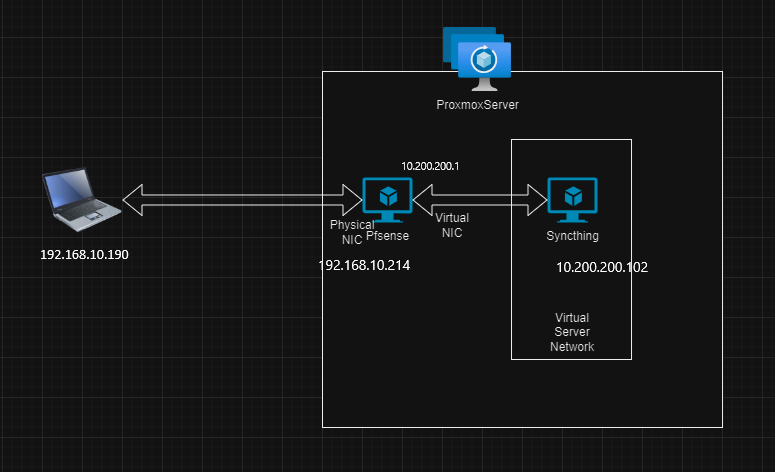

this line seems suspect.
can you add ip’s in your diagram?
I assume laptop is 192.168.10.190 and virtual server network is 10.200.200.*
Hi Pavlos,
Ofcourse, here are the IPs added into the drawing
i can also mentioned that my main router which is my internet gateway has a static route for the network 10.200.200.0/24 poinitng to the pfsense. 1982.168.10.214
