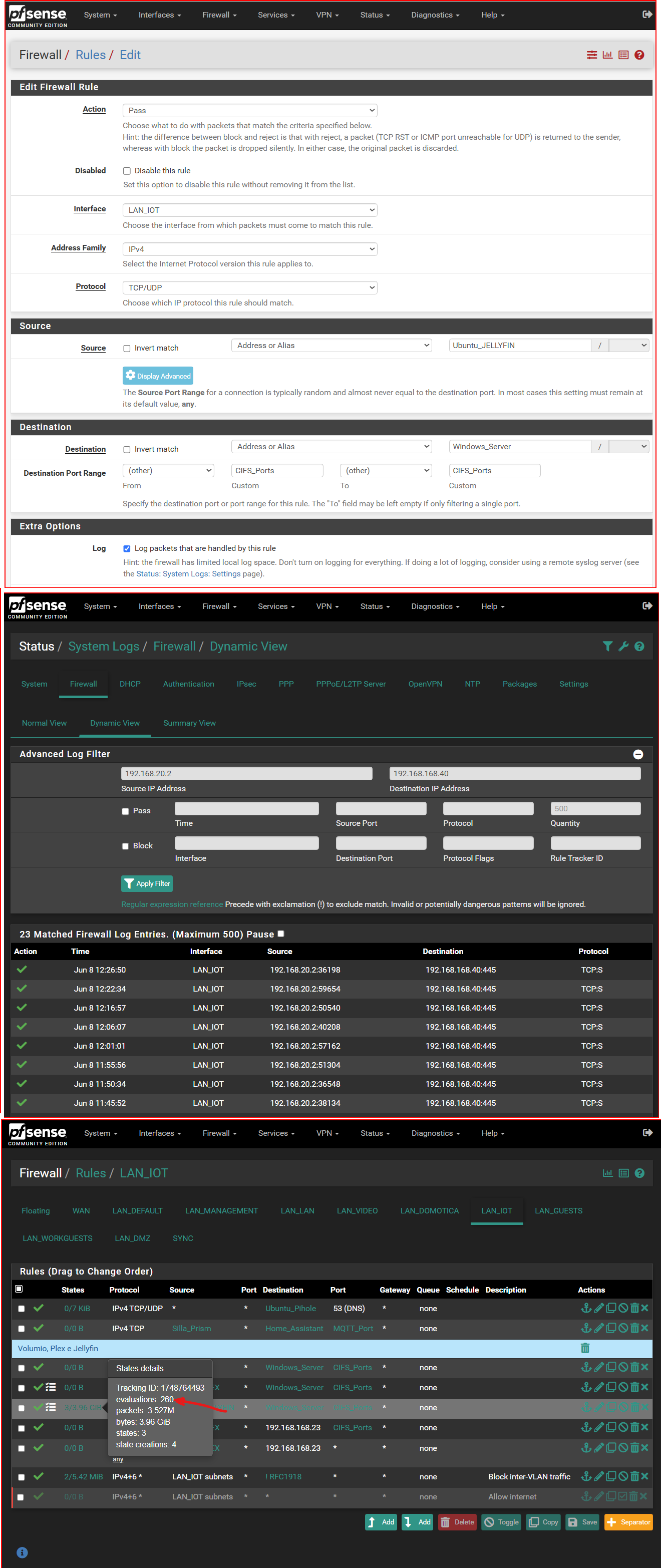

On pfSense I created a rule that allows Plex to access the share on the Windows server.

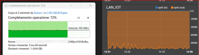

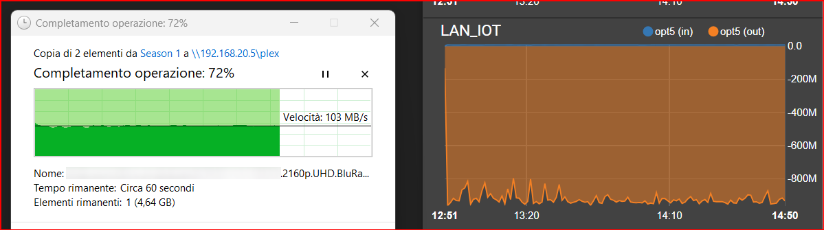

As a test I prepared a second temporary Ubuntu machine on the IoT VLAN, IP 192.168. 20.5, created a share with some files that actually play on Plex without any interruption.
//192.168. 20.5/plex/media/temp cifs credentials=/home/michele/.smbcredentials_temp 0 0
As a second test I moved this same temporary Ubuntu machine to the “LAN” VLAN, IP 192.168. 168.23, and the problem recurred as with Windows Server.

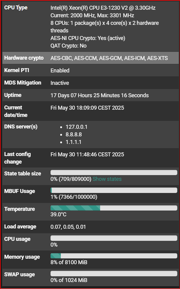

Are you virtualizing pfSense or is it installed bare metal on the R210? If its virtualized it might need more resources assigned to it.

pfSense runs on a physical server and has a lot of free resources.

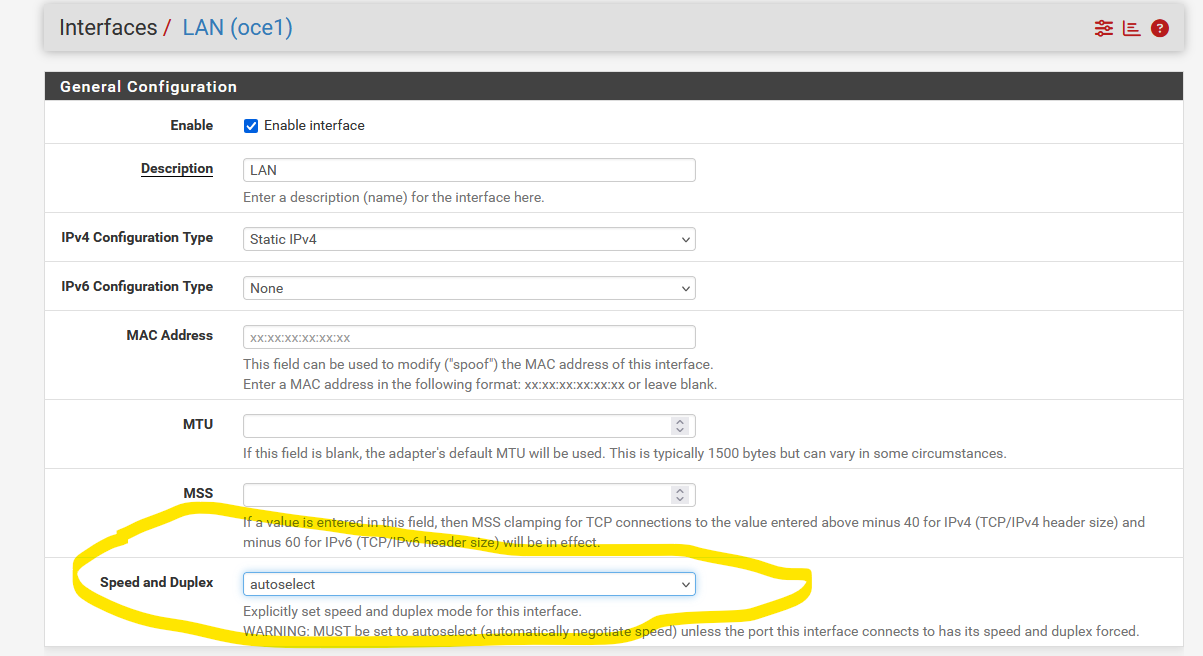

Re-reading your original post, it seems to be an issue only on the LAN VLAN (the 192.168.168.XX network)? If so go into the interfaces tab on pfSense, select the LAN andterface and check to see what speed the adapter is using. Set it to be the same as on your IOT LAN.
Thank you Louie for the suggestion.
Now both the “LAN” and “IoT” interfaces are set to “Default”.
I change them to Autoselect and do some tests.

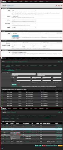

I have enabled the log in the rule that allows Plex and/or jellyfin to reach the server and I see that only very few packets are logged despite the traffic being high.
Furthermore there is no indication that pfSense is blocking the traffic in any way.

Any packet filtering going on between your subnets? Have you setup wide traffic open rules to both subnets at the top just for testing purposes to bypass any other rules

No filtering. The rule are the one that you can view in the last screenshot I have posted saturday.

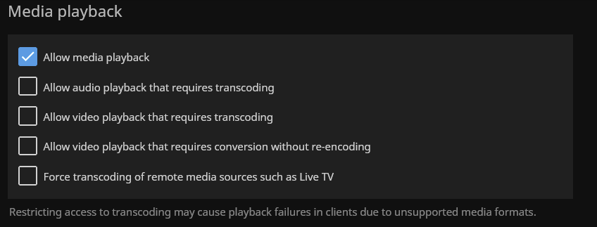

They can stream in direct play mode, but they don’t always. Go to edit your user, then under Profile → Media Playback uncheck the options that allow the user to do server side transcoding. Like this:
Make sure to save afterward.
If your movies are able to play now, then you need to adjust your server side transcoding settings (Server Settings → Playback → Transcoding) rather than trying to diagnose your network connection.

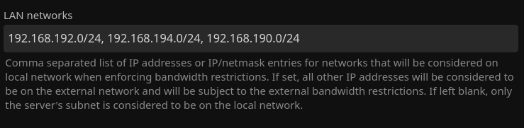

In Jellyfin, go to Administration → Dashboard → Networking, and then add both subnets to LAN Networks as a comma separated list:
Same thing In Plex:
Go to settings → Network → LAN networks and add both subnets:
Note: It may only be necessary to add the networks where the clients are located. However, I added all the networks — both server and client — and it works.
