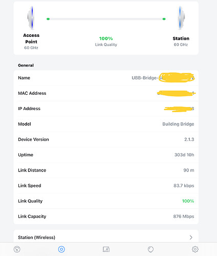

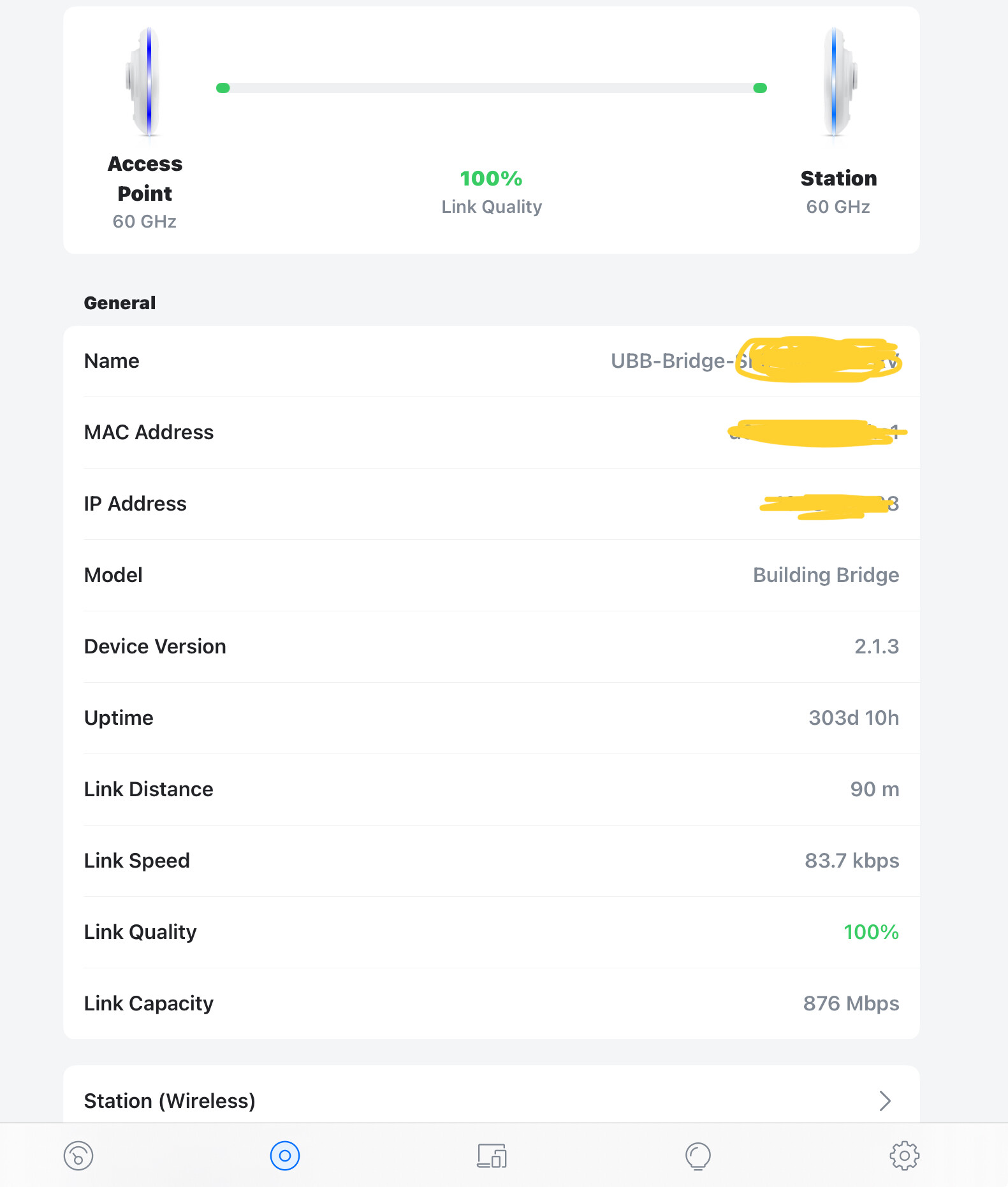

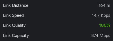

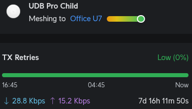

I’ve used the UBB a couple of times now and it works great plus easy to setup. Having all the details in the Unifi interface makes troubleshooting easier although I have not had any issues. Wish it was a bit cheaper though. I have also used a U7 Outdoor and shot a UDB-Pro at it. A little bit cheaper and you get WiFi coverage on the U7 side. Runs just as fast as far as I can tell.

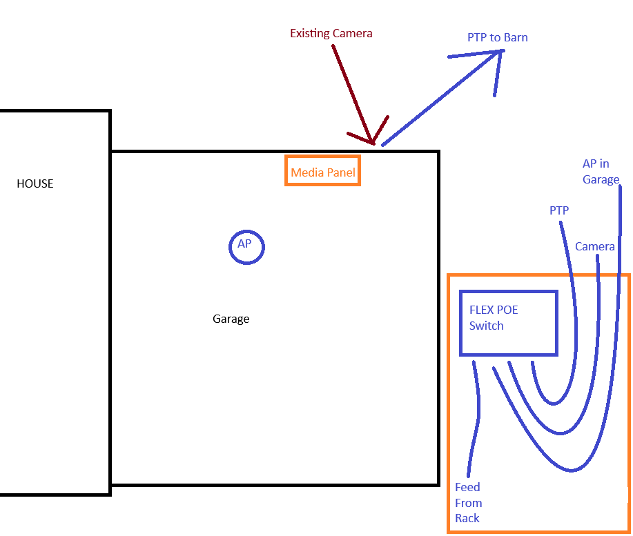

I want to choose a Nanobeam to save money. However, it might not be easy. There is an existing camera in the soffit. I’m going to move this camera cable to a garage media panel. I will use a Switch Flex to provide data and power to the PTP, Camera, and Garage AP. I don’t see an easy way to add 24v POE without AC power injector. I’m comfortable running AC in my own home (I’ve done a lot), but I don’t run AC in others.
I’ll most likely use the Device Bridge PRO or the UBB due to the normal 48v POE I can get from the Switch Flex.
If you use a FLEX POE at the Garage side too, you can use a Instant Outdoor PoE Converter to get your 24V cam on the switch too.

Thank you, for some reason I haven’t seen that product before. It will come in handy if I don’t go with a Unifi option.
