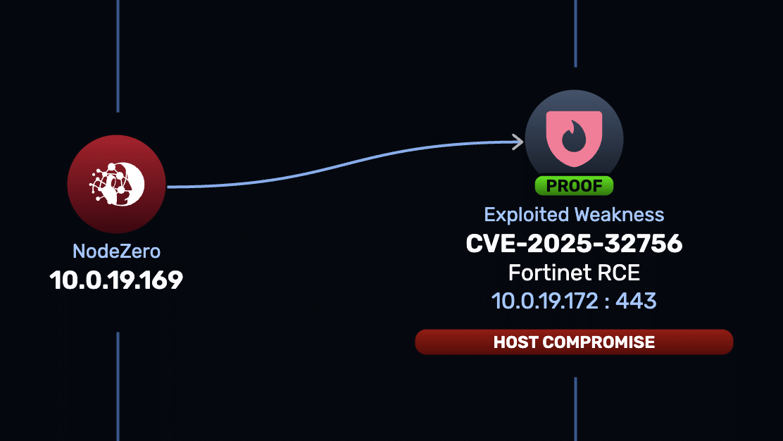

New POC for CVE-2025-32756
Based on this nice write up from Horizon3 here are the security failures
:chart_decreasing: OWASP A5:2021 – Security Misconfiguration
:collision: OWASP A3:2021 – Injection (Command Injection via crafted POST)
:person_facepalming: OWASP A1:2021 – Broken Access Control (Unauthenticated in 2025 really?)

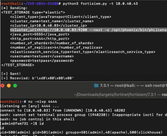

Fortinet is not fast at fixing things
Timeline
14 August 2025 – Reported vulnerabilities to Fortinet PSIRT
14 August 2025 – Confirmed receipt by Fortinet PSIRT
16 September 2025 – Fortinet reproduces findings
5 November 2025 – We inquire on timelines as 90 days is approaching
5 November 2025 – Fortinet PSIRT responds detailing 4 of 5 main branches of FortiSIEM are patched but 1 branch has not yet received the patch, and will miss a typical 90-day disclosure timeline
5 January 2026 – We inquire again on timelines as it has now been 144 days
5 January 2026 – Fortinet PSIRT responds that they hope to fix last branch and publish CVE by January patch cycle
13 January 2026 – Fortinet PSIRT advisory released
13 January 2026 – This blog post after 151 days since initial reporting
