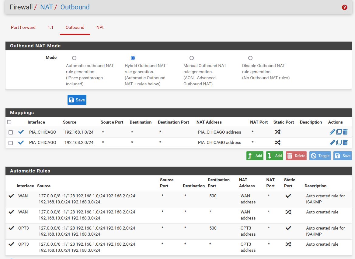

I am following the mullvad PfSense wireguard instructions and I have gotten stuck at the NAT section. I do not understand NAT. However, it seems like they are setting up the VPN so that everything exits through it. I only want to select the specific devices that use it via firewall rules. That is how my current setup works with PIA openvpn. My settings right up to the point where the mullvad instructions tell you to switch to Manual Outbound NAT. I am not sure what I want to do here. The mullvad interface is OPT3. I also have a DMZ configured that is on 192.168.2.1. I am honestly not sure what 192.168.3.1 is. Perhaps a holdover from something else I worked on. I am not sure what is forcing these automatic rules to be generated for OPT3 and why I don’t have them for PIA_CHICAGO. For PIA_CHICAGO I have a set of IP addresses defined by an alias that are directed to the VPN gateway. Hopefully this is enough information to work with. I pressed ahead and added a firewall rule that forced traffic from a specific ip address out the mullvad gateway. It seems to work. I made no changes to the settings in the page below. It seems as though I have some mistakes in the settings below that I would be interested in fixing. I tested the connection to through the Mullvad gateway and got 434 Mbps. I tested the same computer over the PIAVPN gateway and got 111 Mbps.
NAT stands for Network Address Translation, without it traffic from your local network would leave your WAN with the same local IP address it was sent from with no way of getting back to your firewall on the public internet. What NAT does is give traffic leaving your local networks your WAN’s public facing IP address allowing it to return back to your firewall once it gets out onto the public internet. This needs to be set up for your VPN too because the remote server you’re connected to over the VPN is expecting to receive traffic from your WireGuard interface address not one of your internal network addresses.
It’s worth noting that if you send traffic out of a gateway without NAT configured in pfSense whether it’s a WAN or a VPN gateway, then it will still exit that gateway only it will leave with a local IP address and have no way to return once it reaches its destination IP address. NAT cannot be thought of as a firewall rule as it does not pass or block traffic, it merely applies an IP ‘translation’ to passing traffic that matches a mapping.
NAT is used as a solution to the limited number of IPv4 addresses addresses available so that every device behind a network doesn’t need a public facing IP address
So you have it up and running which is awesome. First I’d suggest maybe renaming your OPT3 interface to Mullvad_WireGuard or something similar so you know what interface it is. The 192.168.3.0/24 network I think you mentioned must belong to a network that is or maybe was configured as it’s an automatic rule. If you want to clean up your NAT mappings I’d suggest using manual mode. Once in manual mode edit the two OPT3 mappings changing the source IP to only the ones you have defined as aliases for your VPN gateway, aliases can also be used for these source network(s). Here you can also remove the 192.168.3.0/24 network from each mapping on every interface to clean things up if you’re sure it’s not in use. I think maybe the best thing to do from here would be to spend a bit of time understanding NAT and it should fall into place.

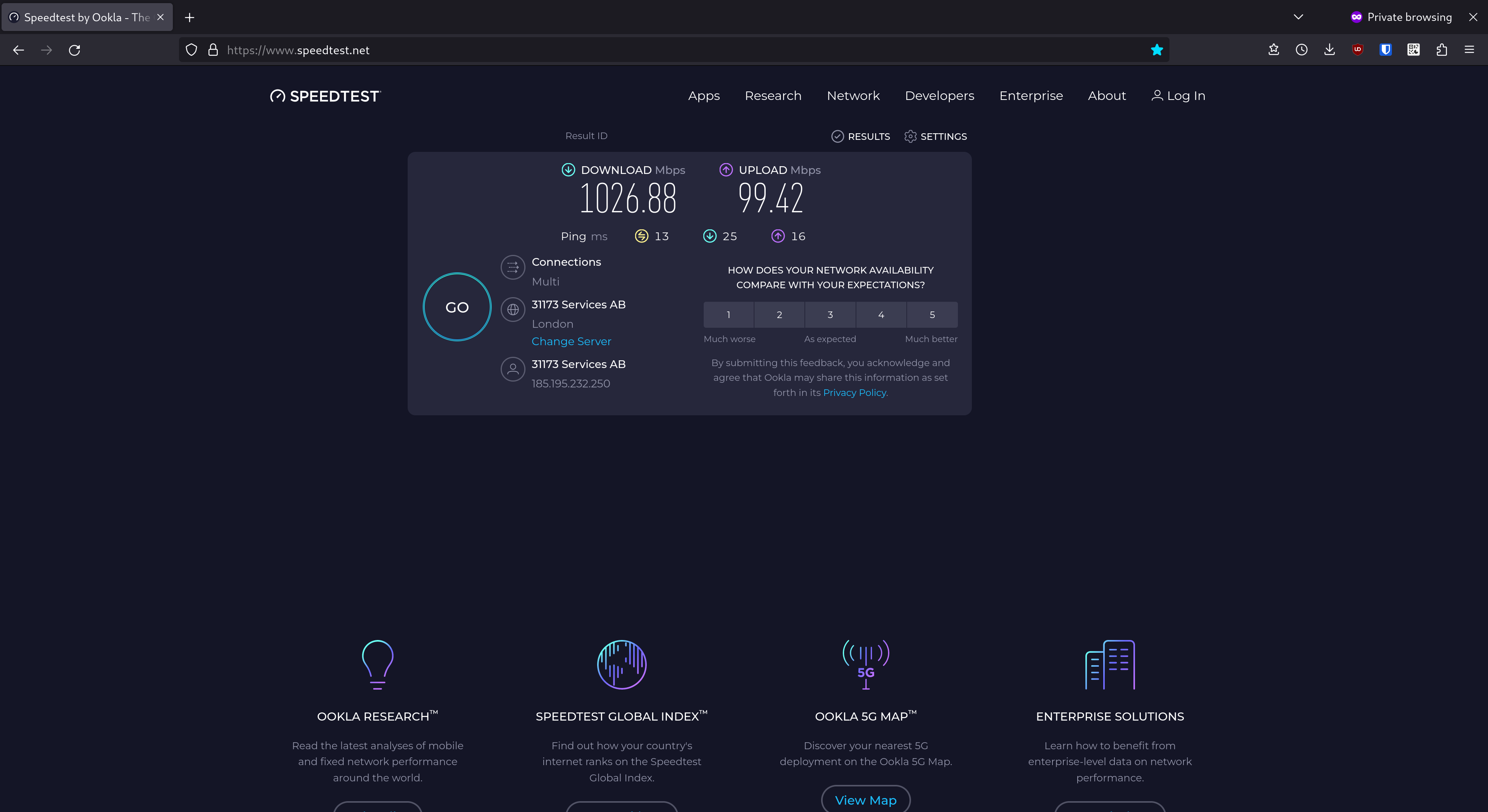

I ended up trying Mullvad VPN with wireguard over the weekend and was about 10x faster than PIA. I am saturating my internet connection. My router CPU usage hit 80% and I had never seen it above 25%.
