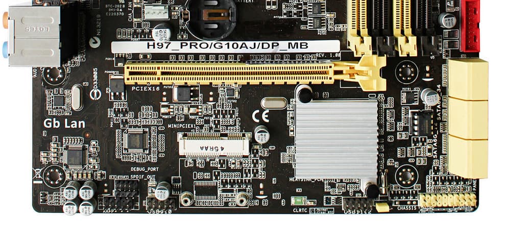

Hi pavlos! Yes, the motherboard is an ASUS H97 PRO G10AJ DP MB.
The PCIe is X16. Access to the BIOS is not a problem. What are your thoughts on what settings I need to tweak? Thanks for taking the time to reply to this post. I appreciate it!

There might be an option in BIOS to enable the pcie slot.
