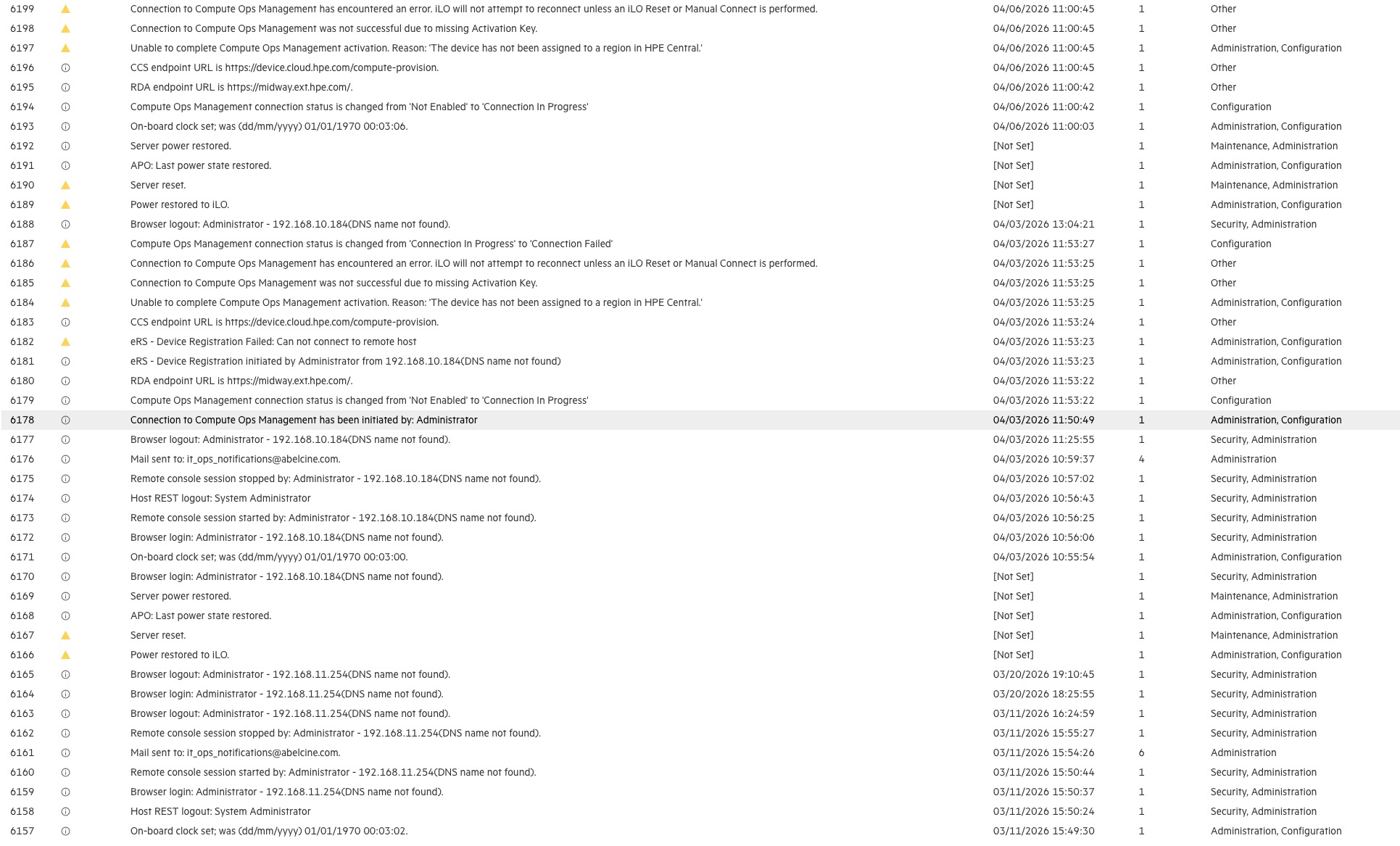

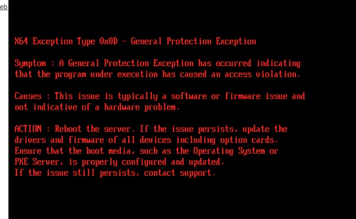

iLO has the following log, but nothing useful. When I try to run Hardware diagnostics, I got this error. (No matter if I run it from the BIOS or Intelligent Provisioning)

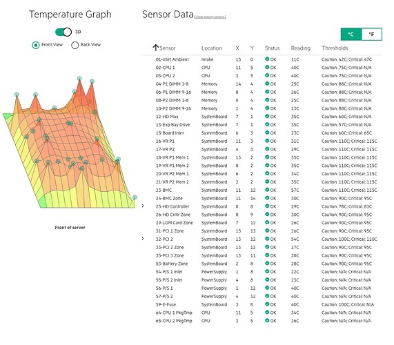

Do you have HP SmartMemory? Is the heat sink compond still good on the CPUs? Might be something there. Check iLO for the heat level, etc. Might be a dead end, though…

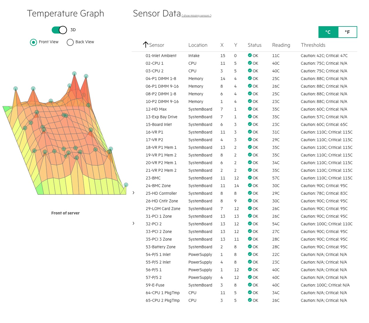

Regarding to the temperature, I don’t see any unusual high spots. I found a loos paper (just the small serial number sticker) and I changed the RTC battery just in case. (It was 3.11 V, the new has 3.2 V that should not be the problem.)

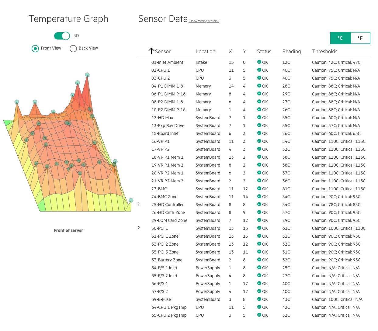

PCI Zone1 seems rather high. You have an add-in card in that slot? I wonder if you have an overheating problem for that card.
I was thinking about that. I did some tests, pushing the CPU to 50-60%, doing fio on the 10Gb card, but nothing happened.
I will do another attempt today, when I can observe it in person.
Pushing it for 20 minutes, only changed 67 to 73 C
Moving the network card down one PCI-E slot and slightly increasing the fan speed decreased the temp from 68 C to 54 C.
Usually the fans didn’t ramp up more than 17%, just occasionally. But it is in a temperature controlled room. Now the fans idle around 34%.

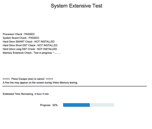

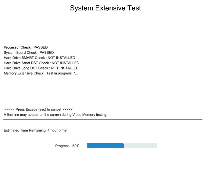

I removed all drives and I was able to start the built in diagnostic tool from the BIOS.
Which indicates that something is not OK with the Proxmox Install

Yes, I tried. But still didn’t allow me to run the test.
However I was running it for a week and no issues. Probably the firmware update solved it. Even support was unable to tell me why. They just gave me the: “remove everything and gradually add back hardware” solution.
