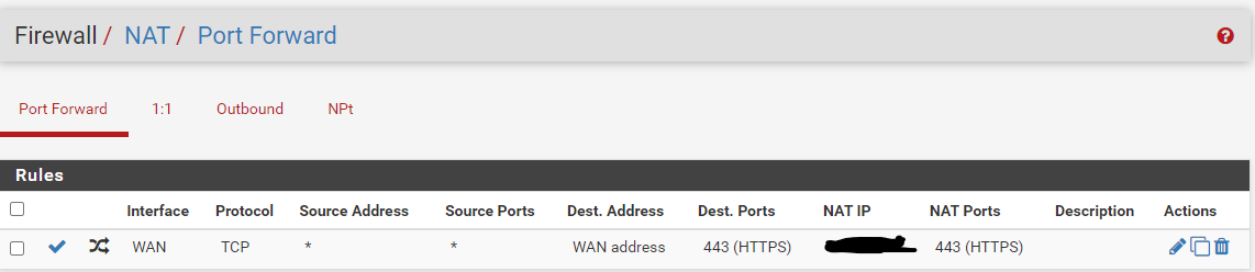

What does your NAT rule look like?
Firewall → NAT → Port Forward
Thanks for the reply @xMAXIMUSx
My NAT rule looks like:
NAT IP pointed to my RRAS server’s internal IP address.
I’m using port 443 as I understand this supports SSTP VPN (I may be wrong here).

What port do you have configured on the management port of pfsense - http or https
System - Advanced - Admin access - if https change tcp port if using 443
On the nat rule, under ‘Filter rule association’ you have created filter rule
Thanks for the reply @Paul
I just checked and it’s HTTPS but there is no port number in the TCP port field.
Do I need to put a port number in this field (something different to 443)?
Regarding the filter rule, it created the rule as part of the port forwarding I created (I can see this under Firewall > Rules > WAN).
Try another port number instead of 443, enter another unused port
Just remember to access pfsense you will have to use - https://pfsenseipaddress:https port
ie. https://192.168.0.1:445
There maybe a conflict between pfsense management port and vpn port - both on 443

Thanks for your input all, I have managed to resolve this myself.
It was related to the lack of a SSL certificate, I thought I could get away with a self signed one.
My port forward settings on the pfSense were correct.
