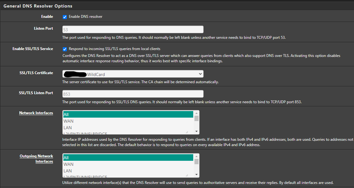

I just finished some additional testing. And I’m curious what the danger is of doing the following:
I can confirm that simply ticking the Respond to incoming SSL/TLS queries from local makes it so that you can leave the DoH setting on and the it the resolver starts to work localy. Maybe it’s as simple as that?
DNS-Over-HTTPS works over HTTPS but I think the browsers check local DNS if they fail to resolve and entry, either way I recommend turning DOH off.
