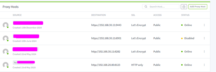

I am wanting to use NginX Proxy Manager to reach my HomeAssistant server.
My domain is ha.mydomain.com
Initially I am trying without any certificate.
In NGINX Proxy Manager I am using http://myip:port which resolves correctly on my network.
I have websockets support enabled.
Under advance I have tried the following:
proxy_set_header Host $host;
proxy_set_header X-Real-IP $remote_addr;
proxy_set_header X-Forwarded-For $proxy_add_x_forwarded_for;
proxy_set_header X-Forwarded-Proto $scheme;
I have tried both $host and myip:port
When I try browsing I get bad gateway.
curl -I http://ha.mydomain.com returns
HTTP/1.1 400 Bad Request
Server: openresty
Date: Fri, 23 May 2025 09:34:00 GMT
Content-Type: text/plain; charset=utf-8
Content-Length: 16
Connection: keep-alive
All my other reverse proxy sites (which are working) are on a 192.168.30.0 subnet but this site is on my 192.168.20.0 subnet. For testing purposes I have removed all firewall rules that blocked traversing the subnets so hosts on iether subnet can reach each other.
I do have the correct DNS entry for ha.mydomain.com
