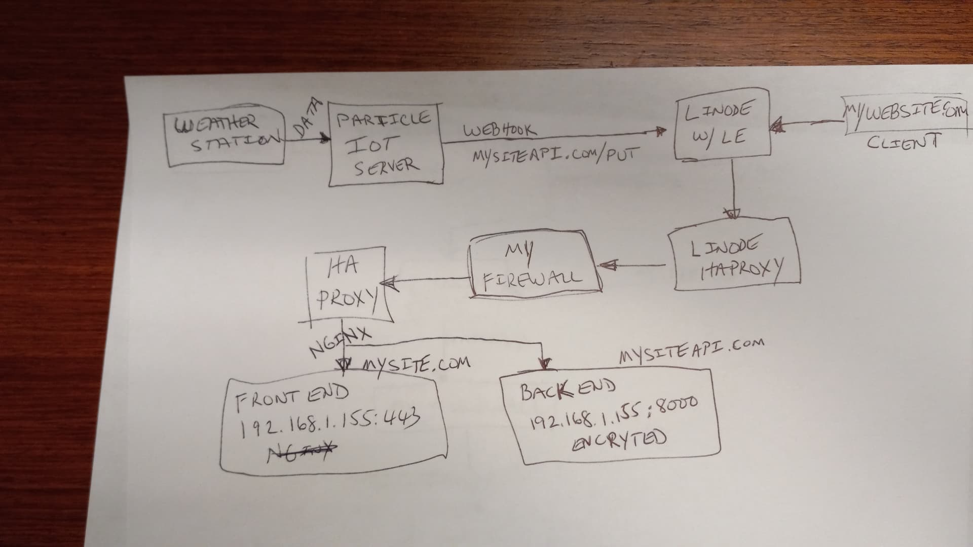

Thanks. One thing that got me confused in the video was the term Self Signed Cert. I assume that the certs I generate in pfsense using the api key from my domain provider are not self signed. Since lets encrypt uses the domain for verification. Is this correct? I included a picture of what I am doing. I believe the part I am missing, or that doesn’t work, is the encryption for 192.168.1.155. I suppose I should say that I understand this isn’t how things are normally done. I have a freenas server and the main reason I am hosting things is so that I can store the weather data on the freenas drive. There is going to be very little use of the site.
Yes, HAProxy can be configured to use a Let’s encrypt certificate.
@theaddies , yep. Just be sure you use acme in pfsense to obtain that cert. Then reference it from HA proxy settings.
OK, thanks. That is what I am doing. The thing that I have not done is installed a certificate on the machine for the front end and back end. When I was testing things out it seemed as though I had an incomplete encryption chain. When testing the API the browser I was using refused to transfer data because it said part of the route was unencrypted. I assumed this was the route from nginx to 192.168.1.155. To encrypt that step I believe I need to modify the nginx.conf file to route through 443 for the frontend and 8000 for the back end with both routes having certificates. Is this correct reasoning? Thanks again.
