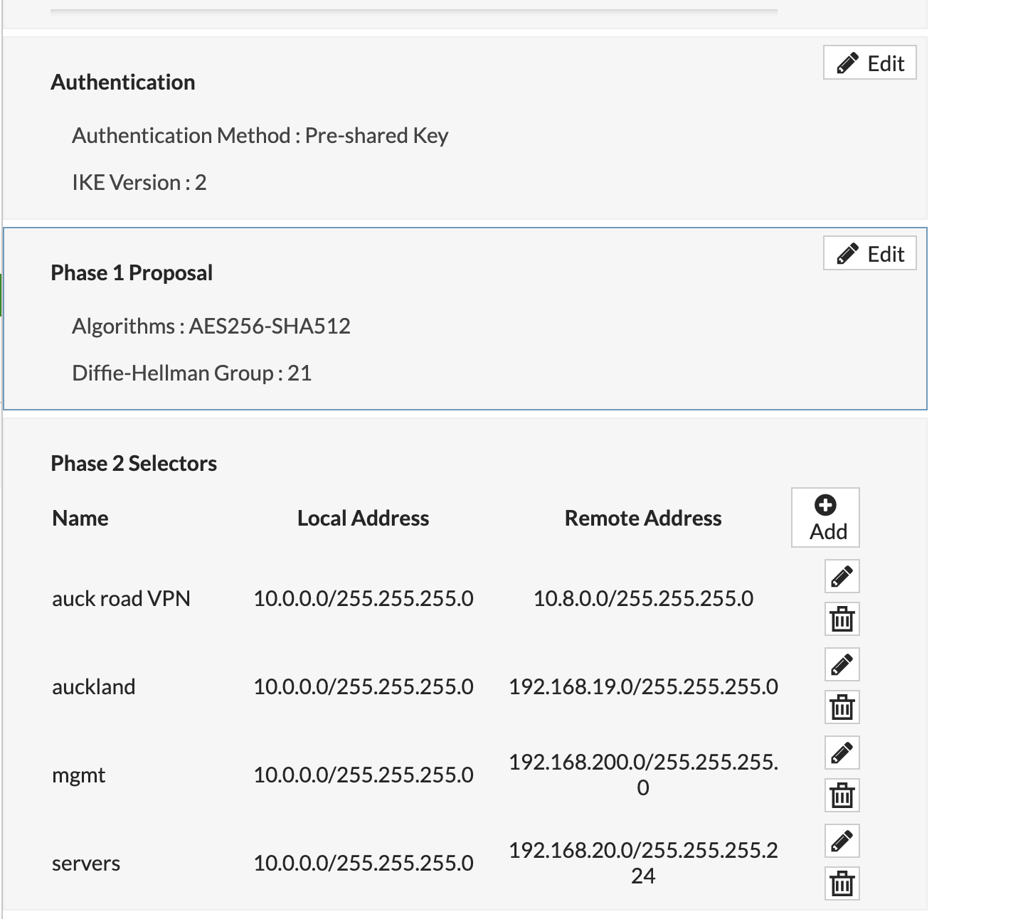

So atm I have an IPsec tunnel between my home and my friend’s home mikrotik here FortiGate there
atm my config looks like this

then my Mikrotik config below
at my friend’s house, I have an IBM server and VMS just on 10.0.0.0/24 subnet no vlans
the FortiGate config below
now this works I can ping end-to-end from the hosts and whatnot, but the routers can’t ping each other unless I pick a source address to ping from
But I would like to make this better I would like it to be able to have all subnets at both sites
I don’t think this is possible with the IPsec tunnel as it says to get here come through us
