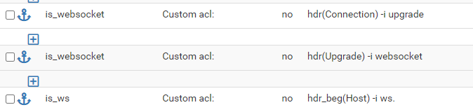

I would post how I made Haproxy support WebSocket that works with my Headscale, just in case others may have had the same difficulty figuring it out.
Frontend

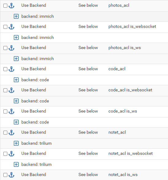

Backend

On frontend acl section, you define websocket acls once
then, on frontend action section, you can refer to them for as many subdomains as you want. In your case, you’ll have headscale1.yourdomain.com, headscale2.yourdomain.com. Your headscale2 can point to the same host ip, but with a different port.
