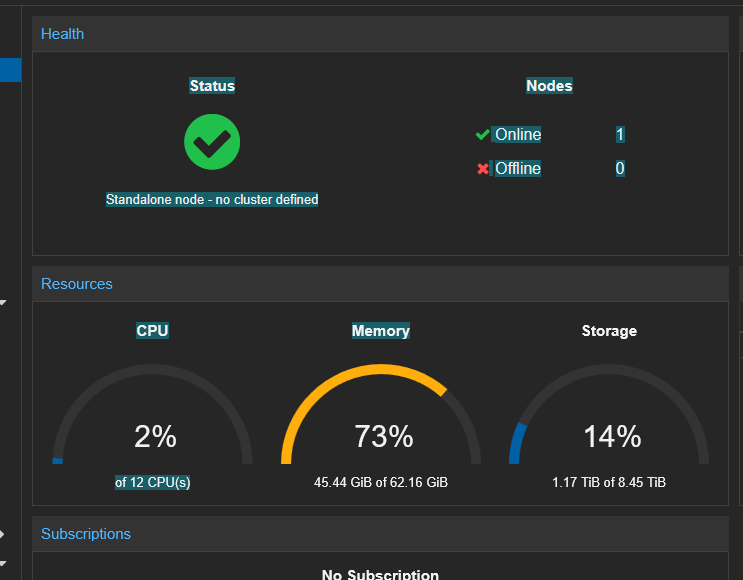

For my situation? Yeah I would stay the same. Performance is fine and TBH, I still have a lot of unused resources. But my situation may not be the same as yours. I split my NAS workloads into three parts really. I have a Synology that is my main storage for family photos and important family docs. My wife needs to be able to access it regardless of what “experiments” I am messing with in my home lab. This is a non-negotiable requirement. My TrueNAS instance mostly provides NFS shares for VM attached storage, docker volumes, Proxmox backups and Kubernetes storage. I have a third virtualized NAS running on an N100 based NUC style computer (openmediavault) that simply acts as a backup location for the other two NAS boxes. As you can see below, with 24GB of memory dedicated to my TrueNAS instance, I still have plenty of RAM free. I don’t use ballooning in Proxmox, so all of my VMs have all of the RAM they need already dedicated to them. I am very satisfied with the system performance.
