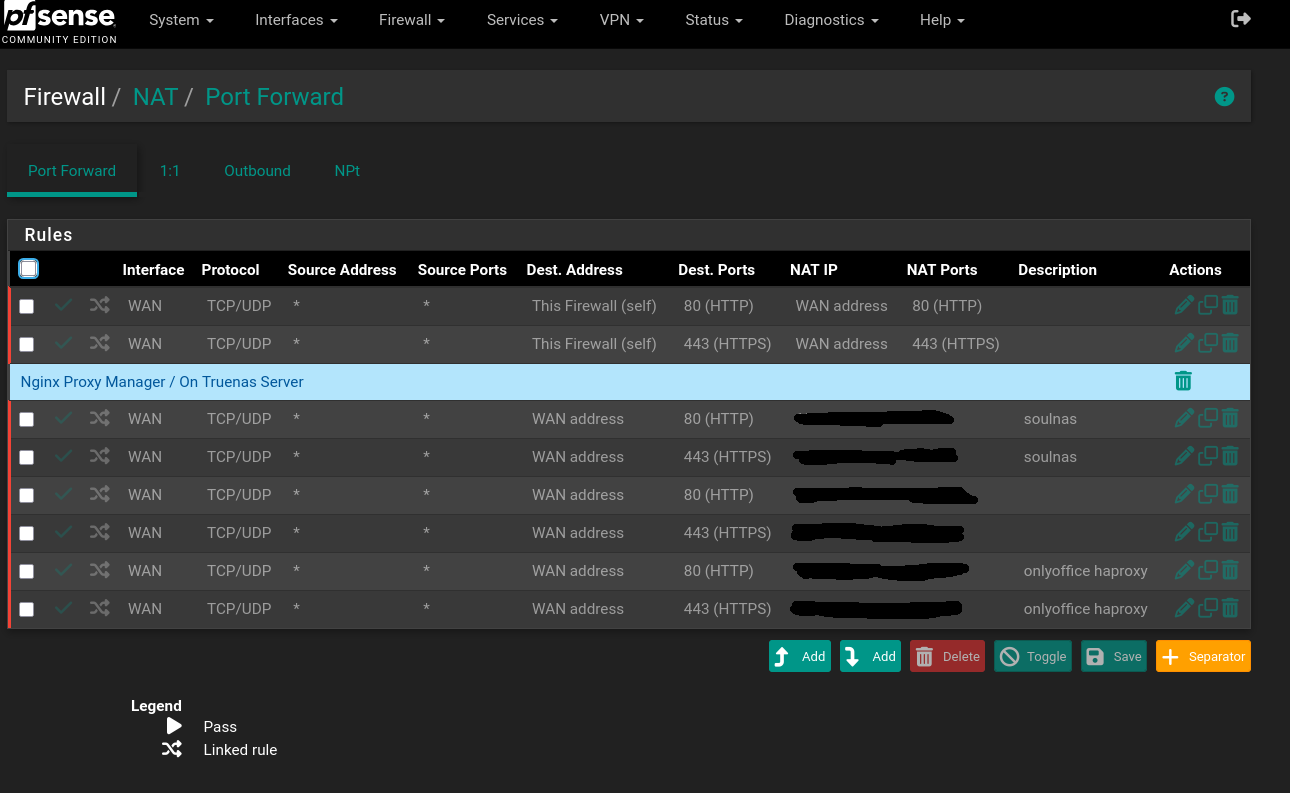

I think we’ll need more information about what behavior you’re seeing. I’m not sure what you mean about no firewall configuration, but if you’re hosting public sites, you definitely need to allow traffic to tcp/80 and tcp/443 via the WAN interface (unless they’ve changed something recently).
My preference is always to have HAProxy listen on a different address from the firewall. I would create a virtual IP (under Interfaces > Assignments), set HAProxy to listen on that IP, and then create a NAT rule forwarding the needed ports on the WAN interface to your new HAProxy IP. If you’re using the Cloudflare proxy (via their DNS panel and not Cloudflare tunnels), then you can even limit the firewall rules to only the Cloudflare IPs. If you’re using Cloudflare tunnels, you don’t need any HAProxy setup at all, so maybe that’s where some of the confusion is.

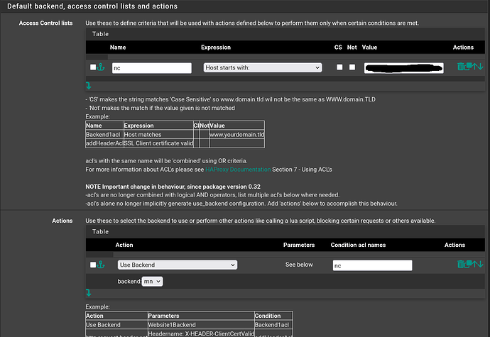

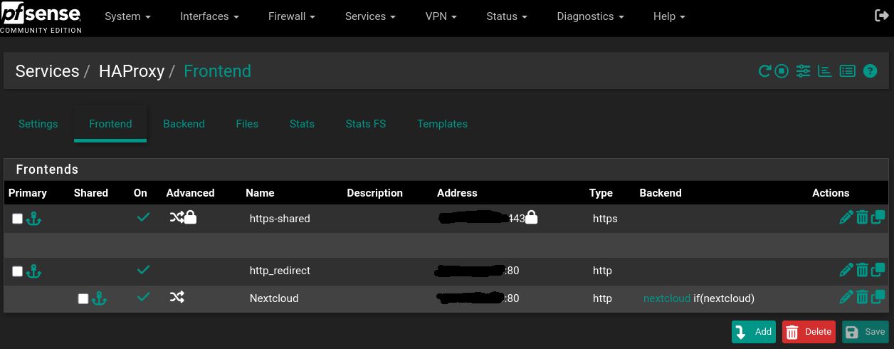

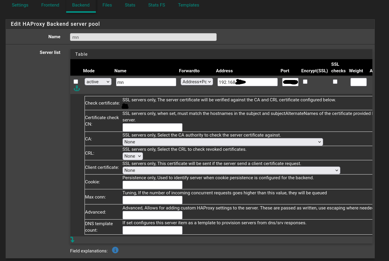

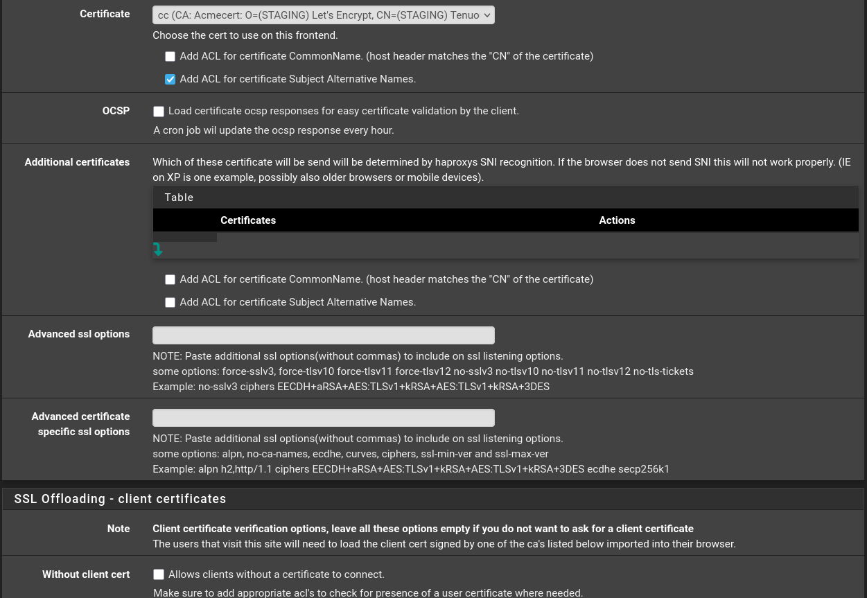

Ill post screenshots of my config as is was and see what you think
Let me be clear, i think i had it setup properly before but i could have been totally off, if you have some pointers or as you have mentioned the virtual ip scenario to share i will gladly upgrade my understanding to produce a better setup as i am very new to haproxy

  1. If you’re binding HAProxy to all interfaces on pfSense (which is the default), I don’t think you need a NAT rule. Let’s say you have a service, nc.example.com. Clients query DNS and get back your IP and HAProxy deals with the traffic. There’s no separate network address to translate the traffic to (which is what NAT does). Instead, a simple rule on the needed interfaces would do the trick. What I’ll usually do in this instance is use a floating rule with the “quick” setting checked and choose all the interfaces I’m after with a destination of “This Firewall.”
    (If you try the virtual IP method, you’d need a NAT rule pointing tcp/80 and tcp/443 to the virtual IP.)
  2. I’m not sure if it matters, but why the two front ends on port 80? I don’t recall Tom’s videos suggesting that and on my own installation I have a single front end for :443 and another for :80, which just redirects to port 443. Instead, the individual services are part of the HTTPS frontend with ACLs directing them to the appropriate backends.

It looks like your issue is with the Nextcloud backend. You’ve got the host set to 0.0.0.0 instead of the Nextcloud IP address. That’s the equivalent of black-holing the traffic. See if updating that backend gets you sorted.
No I only did that for this post I have the real data in my config.
