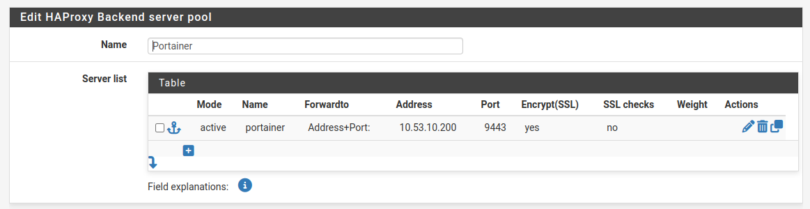

Are you sure the proper box is checked for the back end under Encrypt(SSL)?
Yes to encrypt, no to checks.
Have you tried unchecking the Encrypt(SSL)?
Yes. I have tried SSL on and off and the message persists.

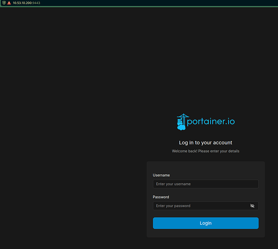

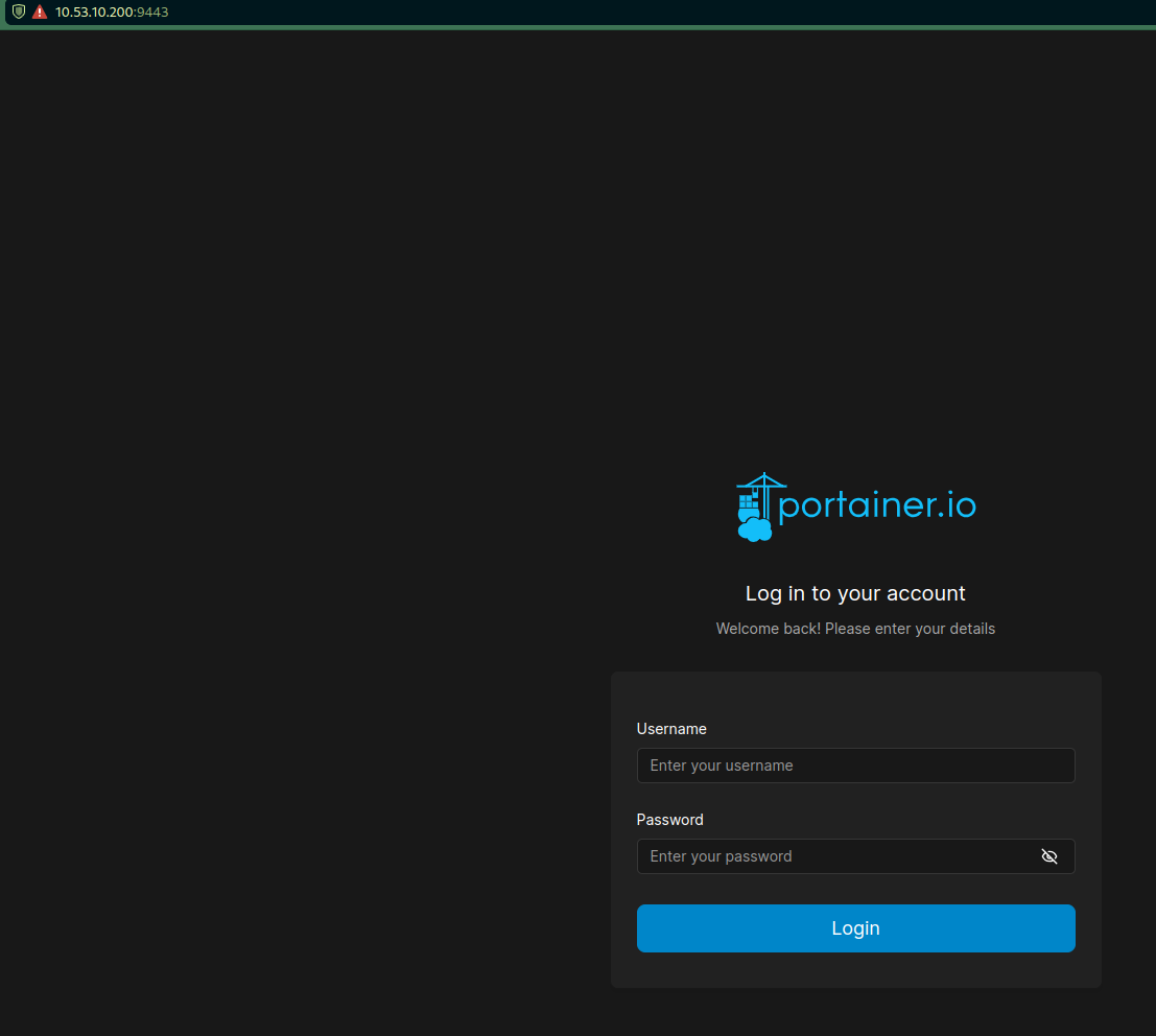

Nonetheless I can access the server just fine using the IP:

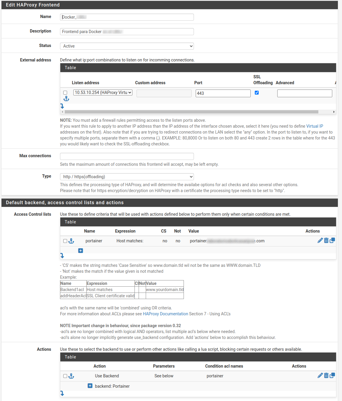

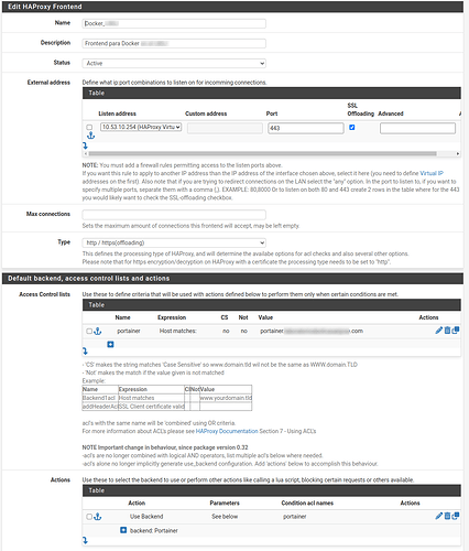

HAProxy frontend config:
And HAProxy backend config:

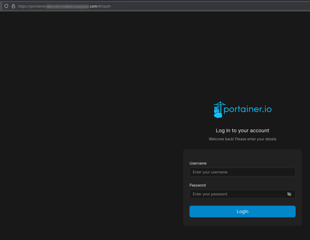

Checked SSL and changed port back to 9443, saved, applied, rebooted (twice): now it works.

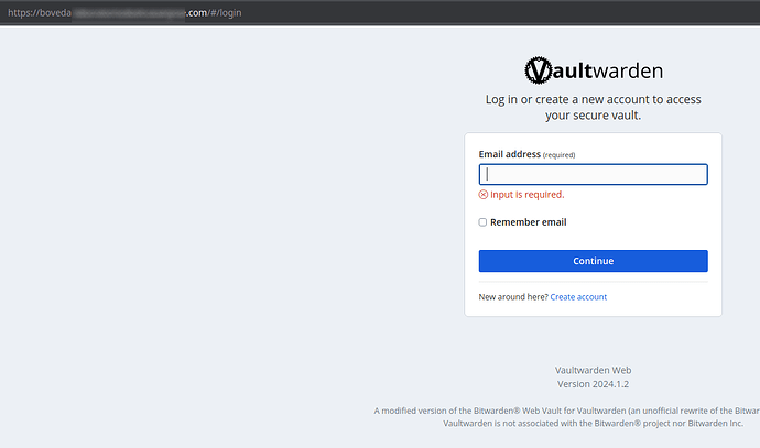

Started another container and after a couple of reboots it too works (after a 503 on the first attempt).

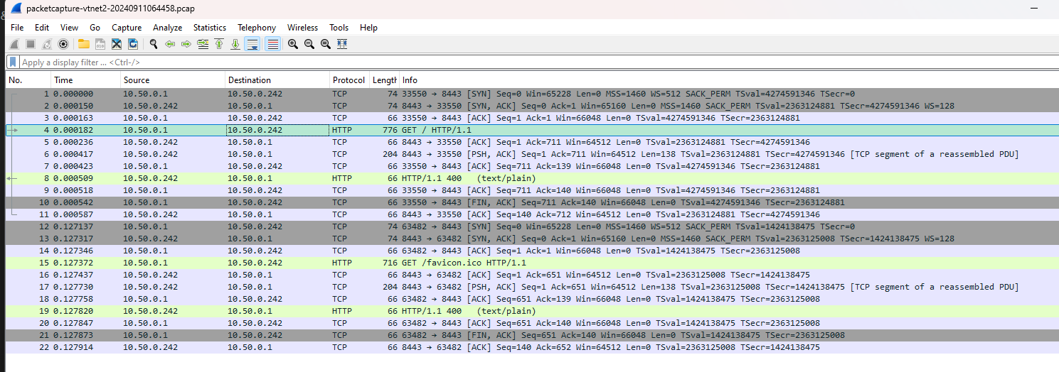

I came across the same issue. It’s checked to encrypt the connection, yet packet captures are showing that it’s not doing that. This is obviously a pfsense bug with it not applying the config correctly. To resolve this issue. I deleted the backend and recreated it in pfsense.
