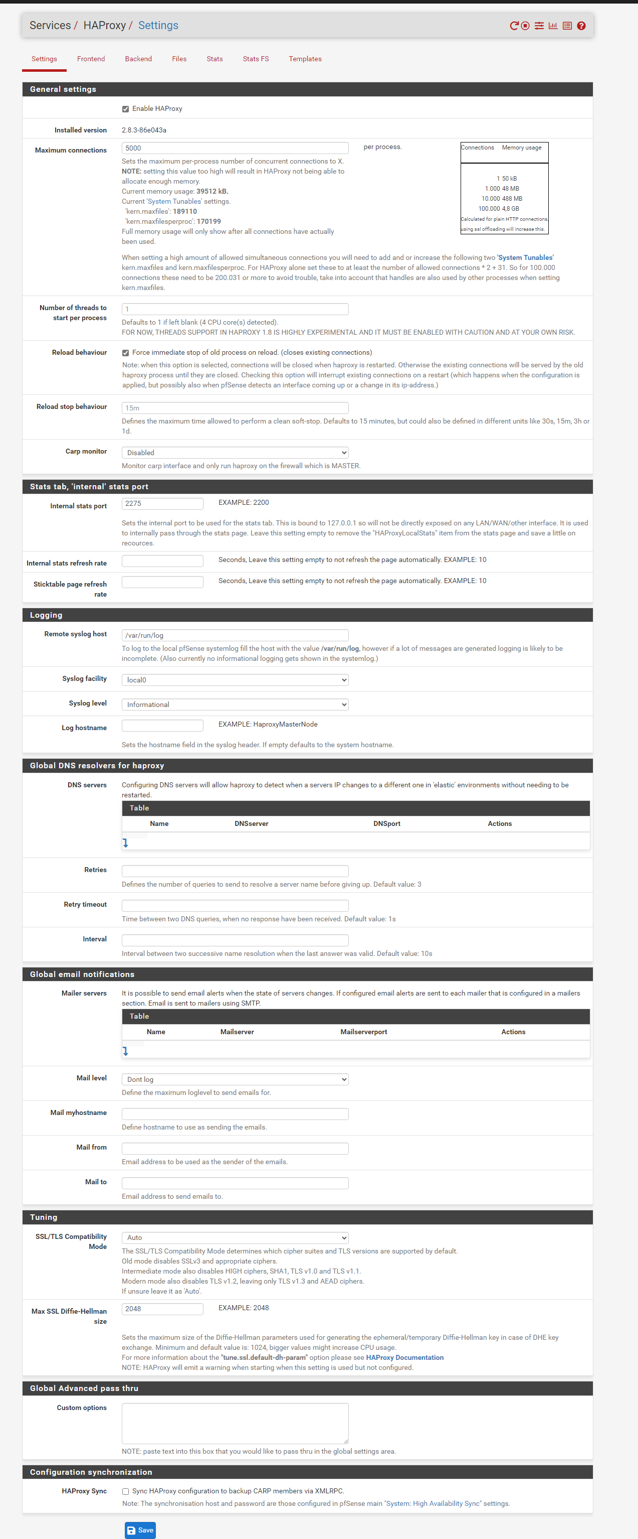

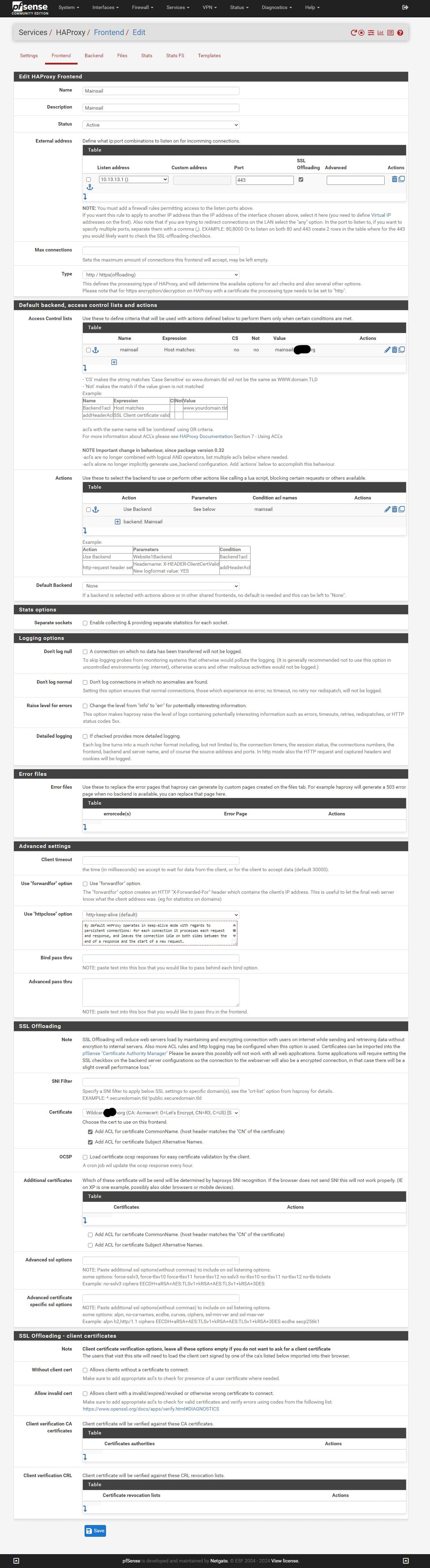

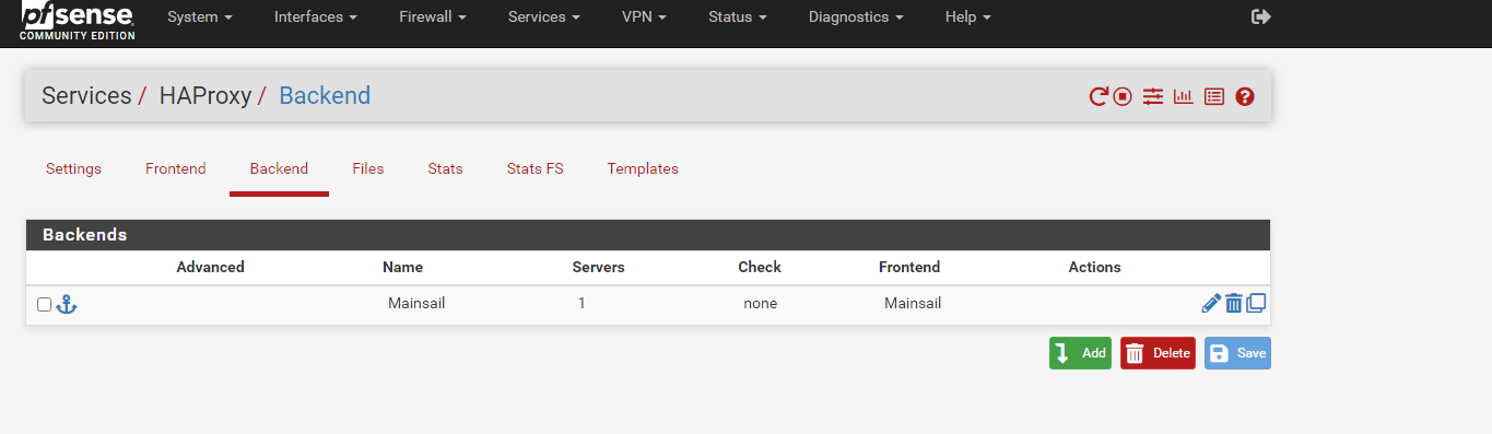

What do you have configured on your front end and backend? Screenshots would be helpful.

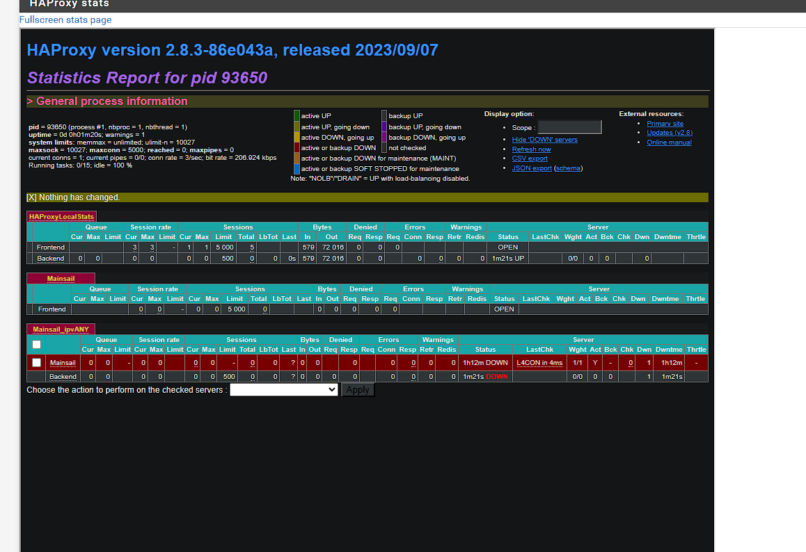

Here’s the first thing I’d check: does the backend show as up on the HAProxy stats page? If not, it could be that adjusting the check method in the backend from the default HTTP to Basic or None might help.
If HAProxy sees a negative test it gives a 503 rather than proceeding.

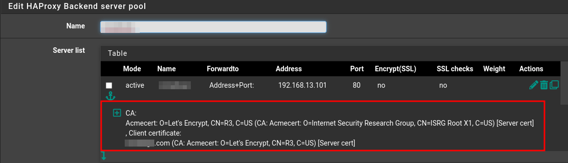

Looks like you didn’t add the CA and certificate on the backend. Look at my config.
Also I don’t have the common name section check. Not sure if that matters.

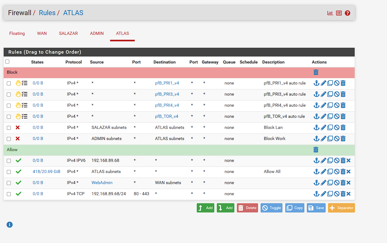

This error means that the proxy cannot reach that IP and port. Do you have any firewall rules that might be blocking access? Or maybe firewall rules on the server blocking access?
Here are my firewall rules. I can ping from main machine and pfsense.
Putting ufw on raspberry pi to force open 8080,443,22.
Doing a port scan they show open.

Done. I am now getting layer 4 connection issues on the status page.

I turned off pfblocker for good measure. Still showing down after restart.

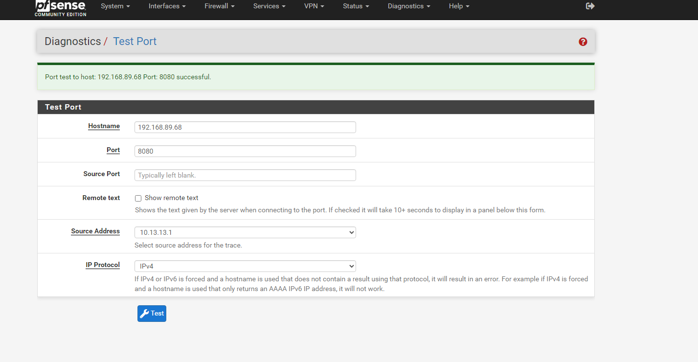

Your DNS is working. The issue is HAproxy cannot reach that IP and port in your backend settings. you need to make sure 10.13.13.1 can reach 192.168.89.68
still not working
I’m the second screenshot, you can see the issue I was suggesting. Change the health check method from HTTP to None and see if that does anything for you. There are some web apps that don’t respond well to the default check for some reason.
