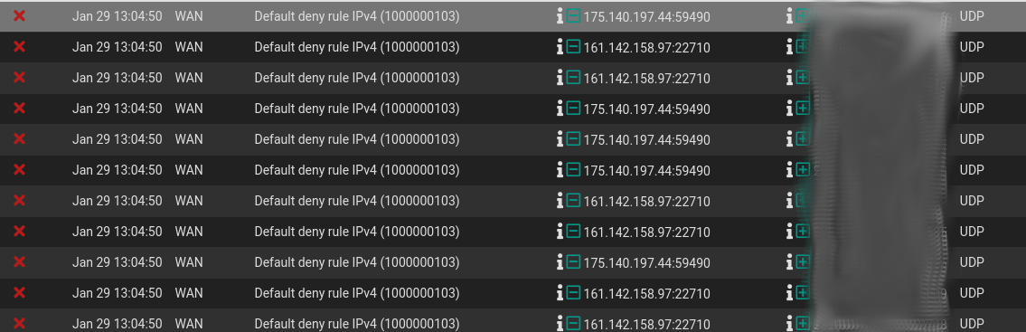

Mostly everything is ok. Speed is fast, most all port forwarding works. But what i’m having trouble with is I used to play a game called RISK of RAIN 2 with my friend and it lags so bad, up to a min and I’m just dead when i spawn. Yikes. So, I port forwarded all the UDP/TCP to my static IP gaming machine. Still does it. So i checked the system logs and it’s blocking UDP/TCP from my friends computer in Japan. It’s part of the default deny rule set. So I allow these UDP/TCP via Easyrule, same result. Since I’m so new to pfsense, I don’t think i have a full understanding of what is going on. And googling this topic always ends up talking about UPNP. Which i don’t believe is the issue. I’ve also tried to enable UPNP, didn’t work.

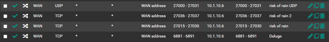

So this is what i have for port forwarding. I failed to mention also I do have snort/PFblocker installed with sub ruleset. IT hand not occurred to me that could be suspect as well. I figured port forwards would supersede Snort/PFB. I’m like babes in Toyland here, I’ve never had so much granular control over a firewall in my life. @LTS_Tom Do you have a video on basic understanding of how PFSense works, a primer so I could possibly answer/understand the many questions I want to ask but refrain.

I just tried to start plex and got bombared with UDP blocks. Same thing happens when i try to play games. It took 2 min before plex finally gave up and i could use it.
