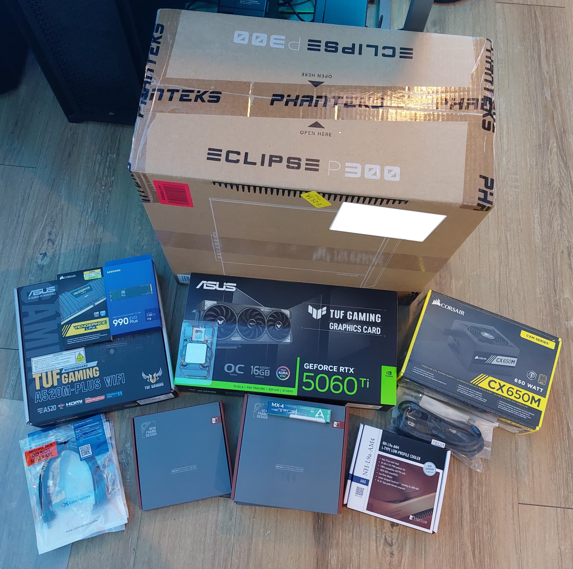

As one last update for this thread, below I have attached a photo of the parts I am using for my AI machine:
Thank you for the recommendations to go with a 16GB GPU, instead of an 8 GB GPU. Having made that change, to the best of my understanding now, is going to be significant in how this learning exercise plays out for me.
Wish me luck as I adventure into territories unknown. Pretty excited TBH.
