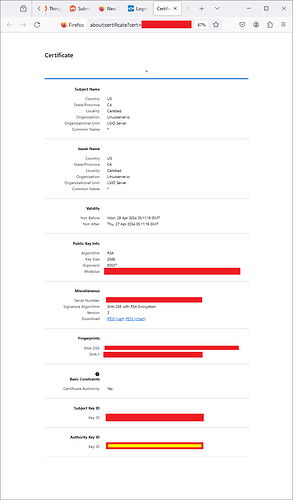

I went to the ip address and port that NC uses and checked the error about not being secure. It indicates that it DOES have a certificate (shown below) but the website “does not provide ownership information”. That sounds like it’s just a self-signed certificate.
But I thought HA didn’t have an issue with self-signed certs.
