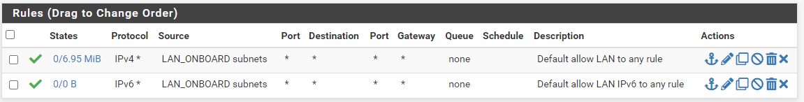

Hello. I recently installed pfSense as a newbie and I was trying to figure out how to enable internet access beyond a single LAN port. I have a quad port NIC that I was trying to enable access to the other 2 ports (1 for WAN & 3 for LAN).
When searching to resolve this, I have found configuring a firewall rule to enable the port on the network but not how. I was able to configure the ports to access the intranet but what else should be added? Thanks
My current rule configuration on the second port:
