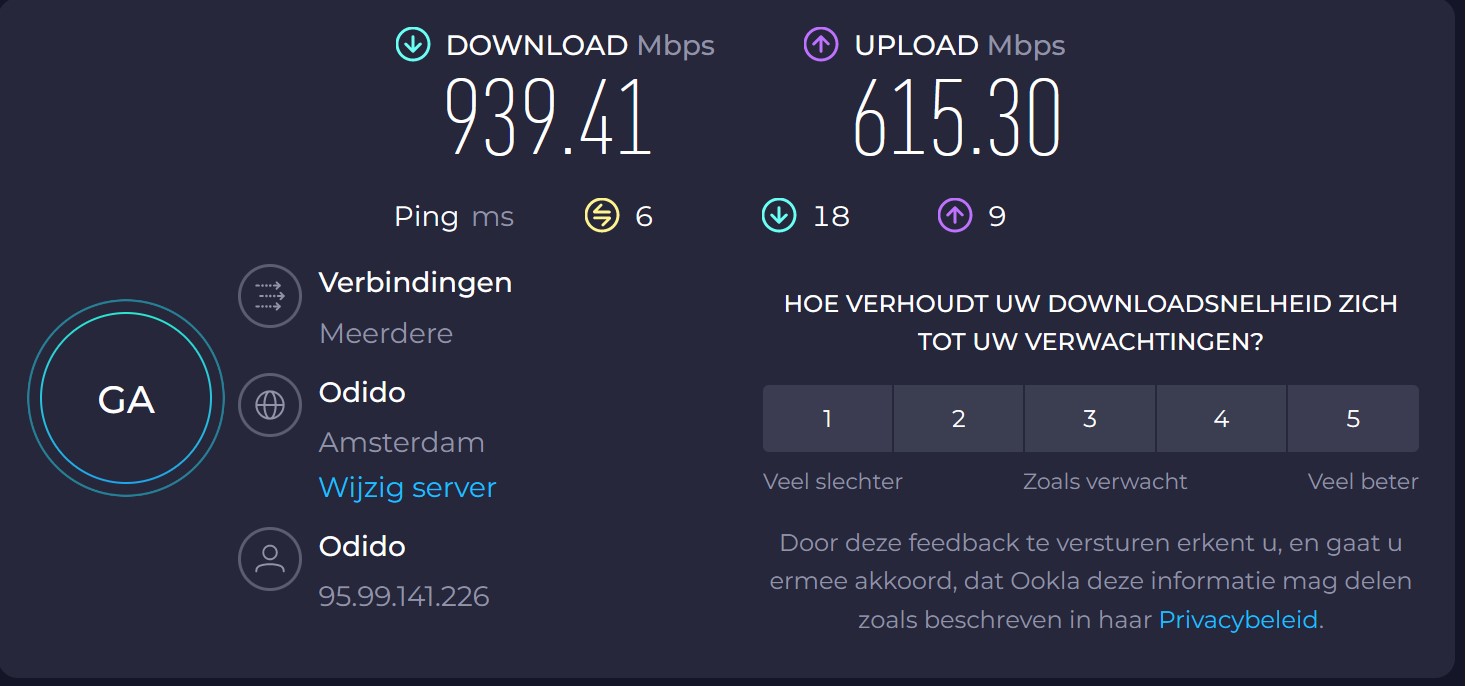

My download is fine, but the problem is the 1 MB upload.
If I access my NAS outside my network and want to download a file, I get the speed of 1 MB.

When I do a speed test (Ookla) I get the values below.

You don’t say what device you are using to connect back to your home network. 1MB might be right.
Personally I would setup an openVPN Remote Access Server on pfSense and then install the client on your device. If you have a friend and a laptop, I would connect your laptop with the openVPN client to their network and see what speeds you get over ethernet.
I would use the remote access options on your NAS as a secondary choice and your router as your primary.
You can use your mobile to see what speeds you get but hard to trouble shoot anything on a phone.
