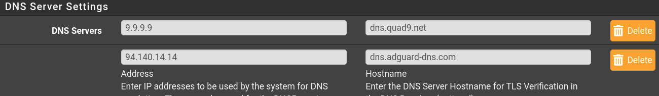

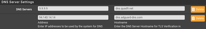

System > General Setup, add 9.9.9.9, Save

Maybe try this for the DNS settings. I’ve had some trouble with CloudFlare not resolving some local government sites.
And these settings in Services > DNS Resolver > General
Okay, thank you all for the responses. Quad9 seems to be working now… Should I have more than one DNS server listed?

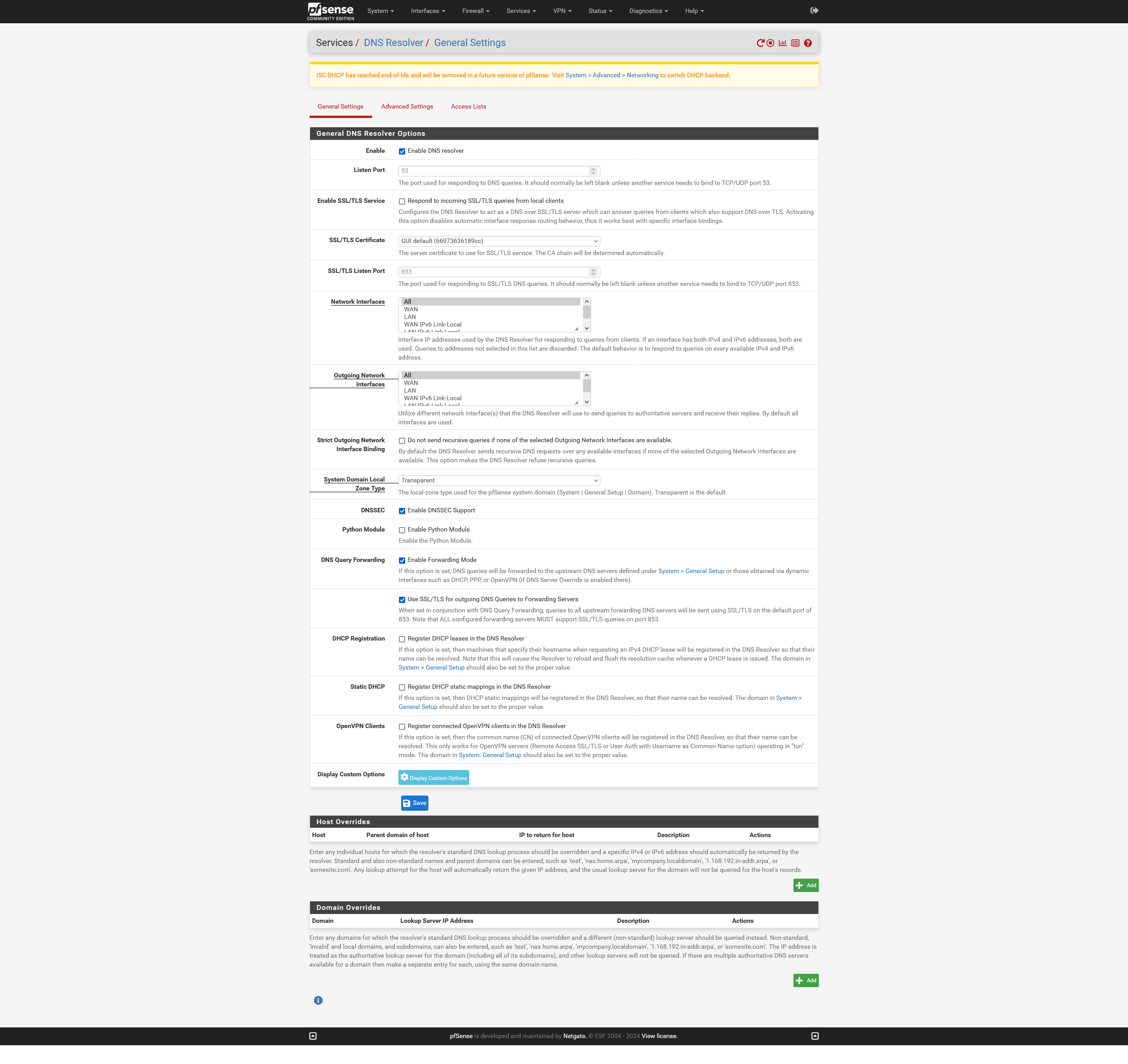

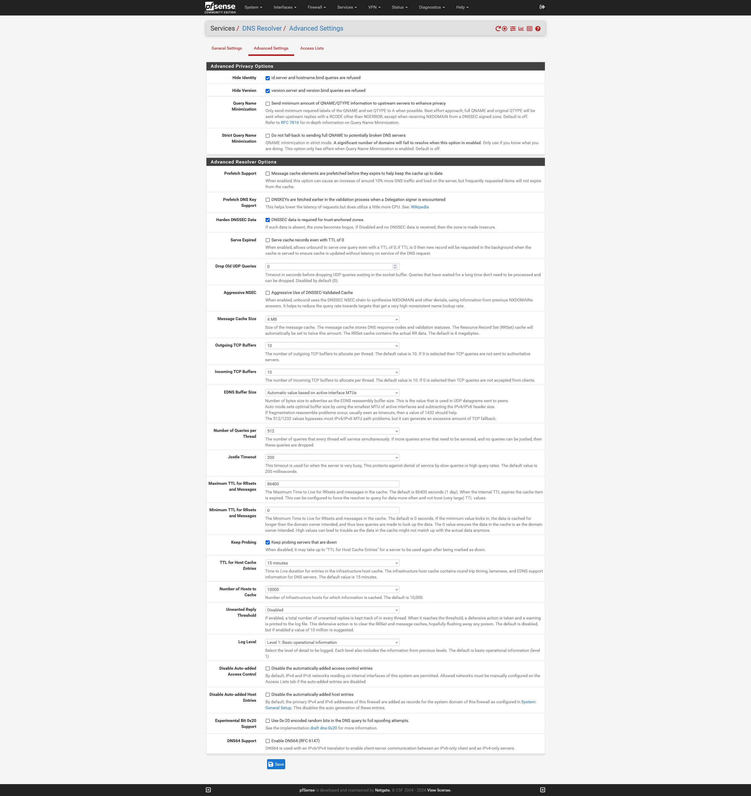

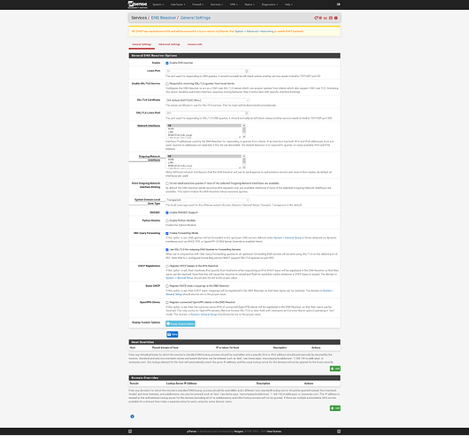

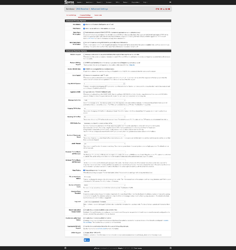

I apologize, I was looking at the wrong page. Here are the screenshots for the DNS Resolver settings.
I don’t think you want DNSSEC on as ‘Use SSL/TLS’ handles the encryption for DNS forwarding. The DHCP registrations are on if you have static IPs set. I use the Host Overrides in conjunction with that for internal servers. That way it resolves to local IP addresses when using the FQDN.

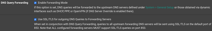

While DNS over TLS and DNSSEC are both security features, they are designed to protect very different things.
DNSSEC is designed to protect applications that use DNS from accepting forged or spoofed DNS data. All responses from DNSSEC-protected zones are digitally signed, allowing a DNS resolver such as Unbound (if the DNSSEC checkbox is enabled) to verify that the information is identical to the information published by the zone owner and served on an authoritative DNS server.
DNS over TLS, on the other hand, adds transport layer encryption that encrypts the DNS queries you send to and the responses you receive from a DNS resolver, similar to how HTTPS encrypts traffic sent to and from an HTTP server.
So while you’re right that enabling DNS over TLS is the most useful thing to do in this particular case, it’s not an either/or question, because even with Unbound running in forward mode, sending the queries to an upstream DNS resolver over an encrypted connection, it may still make sense to enable DNSSEC as well, since it can still validate the DNS responses it receives from the upstream resolver, which in this case is Quad9.
Of course, if you trust Quad9 not to tamper with any responses before sending them back to you, you may as well leave it disabled.
Disable DNSEC and only enable ‘DNS Query Forwarding’ and ‘Use SSL/TLS for outgoing DNS queries to Forwarding Servers’ this should solve the issue.
