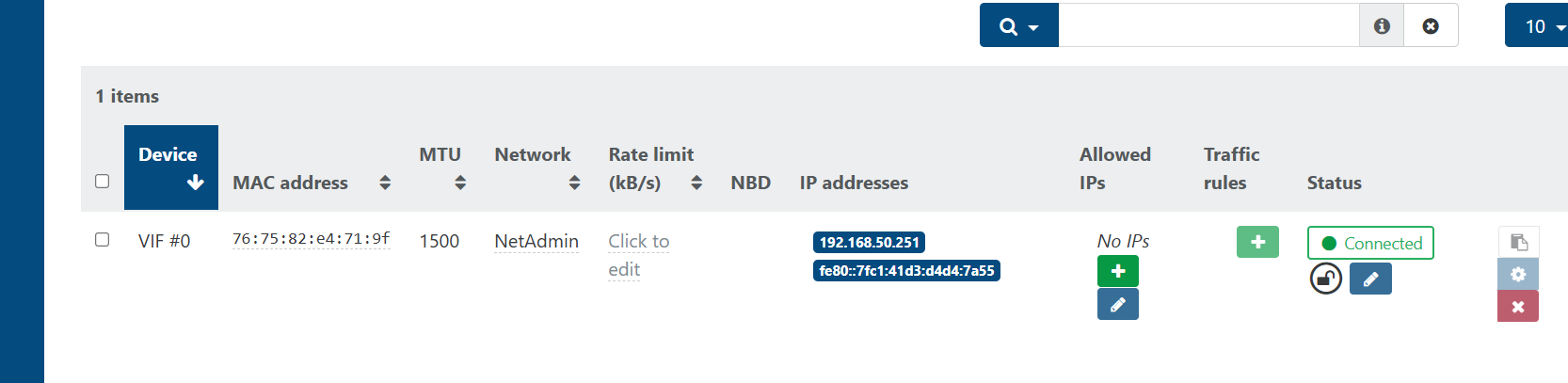

@LTS_Tom Just need a bit of guidance here. In your VM, are you using multiple VIFs (which i dont believe you are doing based on the video) or did you set up trunking in the Debian system?
It seems you are trunking that one interface but i guess i want to know who is doing the vlan tagging? The Virtual Machine i assume?
Can you share just the snippet of your config? Just the network piece.
“If you are running in XCP-ng as I am, make sure the VIF is able to access all VLANs.”
Here is my VIF…How do i make this talk to multiple vlans?
Make sure the switch that is connecting to the XCP-ng host is bringing all the VLANs to that host.
That was the exact thing I was missing. I had it on a VLAN network, not on the main/bonded network.
