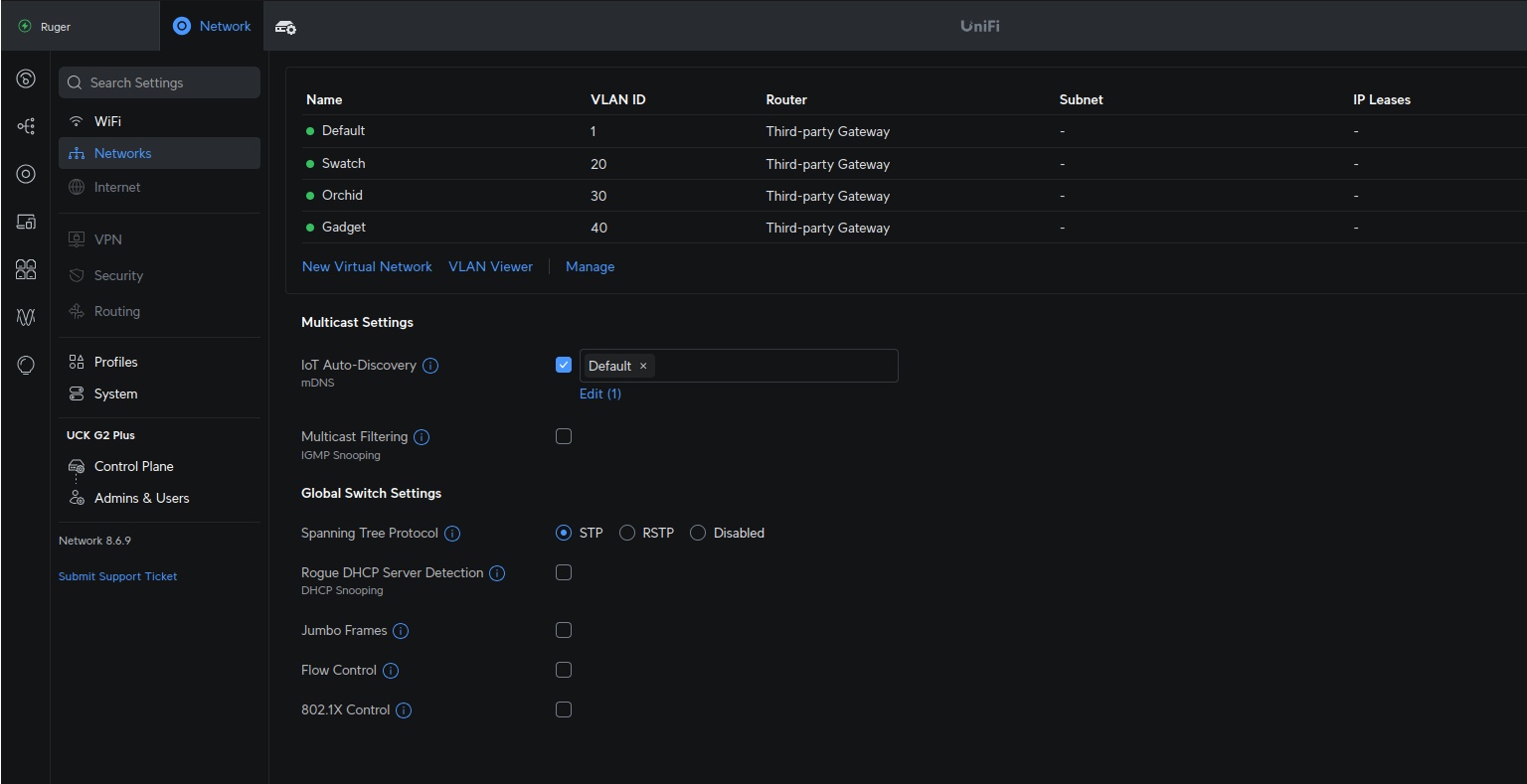

  6. In the Unifi Controller network configuration maybe I have something incorrectly configured? see images below.
Thanks! - Heath

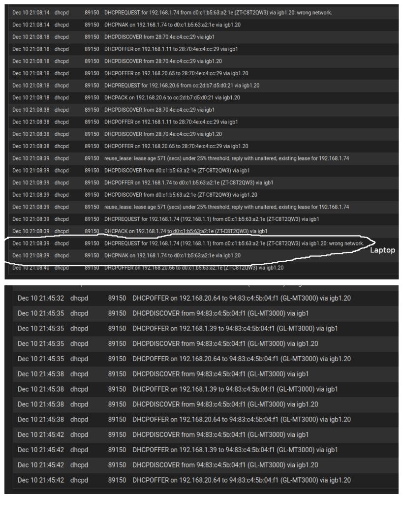

Hi Tom, Thank you for your response. From the logs, DHCP is responding to a mac address on more than one network. My laptop receives an ip address from the LAN network and VLAN 20 but not my other VLANs. Is this correct behavior?

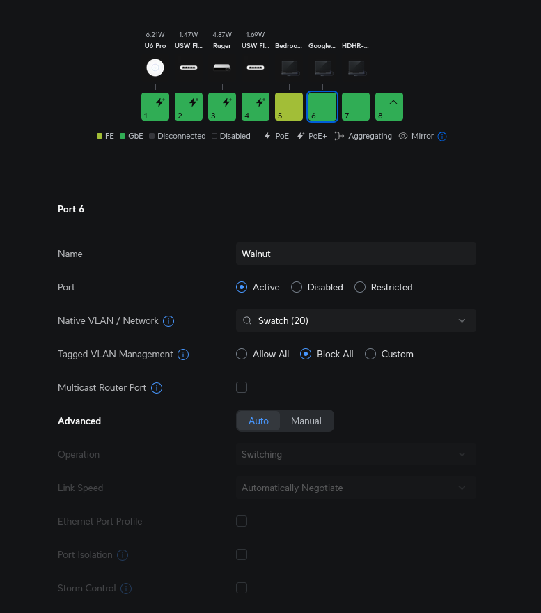

On the Unifi switch in the old controller I selected ALL for the port profile in the new controller I have Allow All selected on the uplink port and port to device as I want the LAN networkl. My travel router receives two ip addresses one from LAN and one from VLAN20 and fails to connect. When I connect it to the parent switch it connects.

Please copy paste logs, not screen shots as they are hard to read.
When looking at the logs it show the IP given, the MAC and then the interface.
DHCPREQUEST for 192.168.60.25 from 9c:8e:cd:2b:78:2e via igc2.60
DHCPREQUEST for 172.16.16.50 from 00:a0:98:79:3b:b8 via igc2
In the above example the native network is igc2 and the VLAN on that interface is igc2.60 which is VLAN 60.

In the below unifi port configuration for igb1.20 connected to a non vlan capable wifi I changed from “Allow All” to “Block All” and do not see multiple networks /vlans responding to a dhcp request anymore. I also changed ports set to default igb1 native to “block all” with exception to uplink ports connecting switches to the pfSense trunk. This I’m lacking understanding as I thought a port receiving all tagged and untagged traffic would always default to the native igb1 interface?
