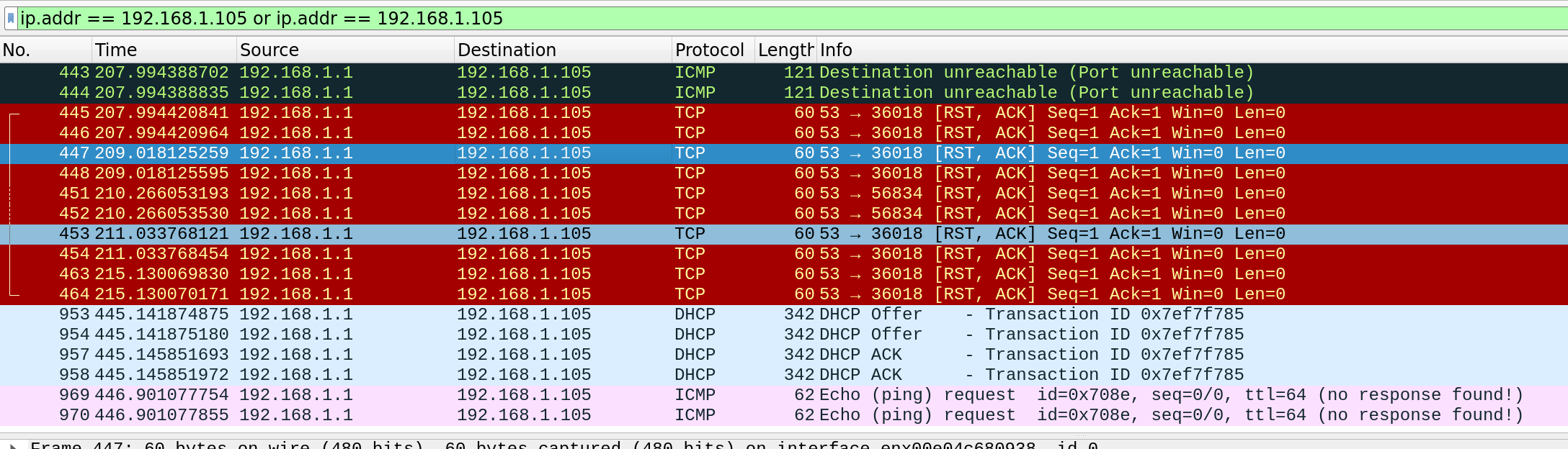

I also configured a SPAN port the on switch to receive traffic from both ports 6 & 7 on port 24 and started capturing with wireshark. The capture below is from when I restarted the VM. You can see when it gets its IP over DHCP, but other than that there is no connectivity. It also does not show any packets when I continously ping the pfsense IP from the VM, even though the ping succeeds.
So to sum it up I set up another network with the exact same configuration that works, I get an IP on the VM and can ping the new gateway, but no other connectivity. I have no idea what else to do or what is causing this.
