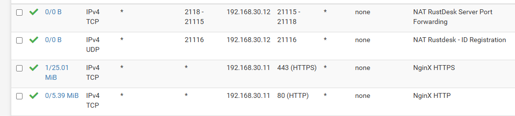

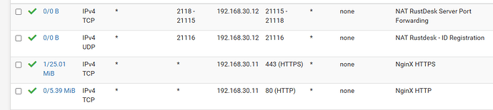

My port forwarding looks as follows:

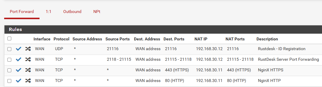

With the following rules on the WAN interface:
Not sure what I might be missing.
There is a typo in the ports for your setup, you have it going from 2118 not 21118

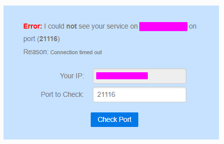

Oops, thanks. Correct that but still same issue. I also added all the ports, including the Pro ones in case I missed something
But get the ports still appear blocked externally when checked from https://canyouseeme.org/
The same happened with the other ports.

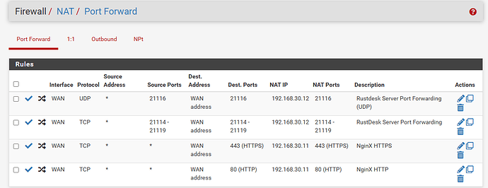

I tried disabling all blocking rules on my firewall and this made no difference.
My port forwarding works for my NginX on the other docker server so not sure what might be the issue here. I have confirmed no linux firewall running on the .12 box.
You have to set your source ports to any on your NAT rules. Those ports will always be random coming in.
Ok, so the two forwarding rules for Nginx Proxy Manager are breaking it for the Rustdesk ? I tried specifying 443 source port for NginX 443 port forward and 80 for the other but then my websites listed in NginX cannot be reached.

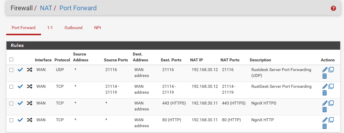

Unless you are using the pro version of Rustdesk there is no web interface and no reason to use a proxy.
Yes I realise, I just added all ports while I was troubleshooting in case I was missing something but I don’t seem to understand port forwarding like I thought I did as I can’t get through.

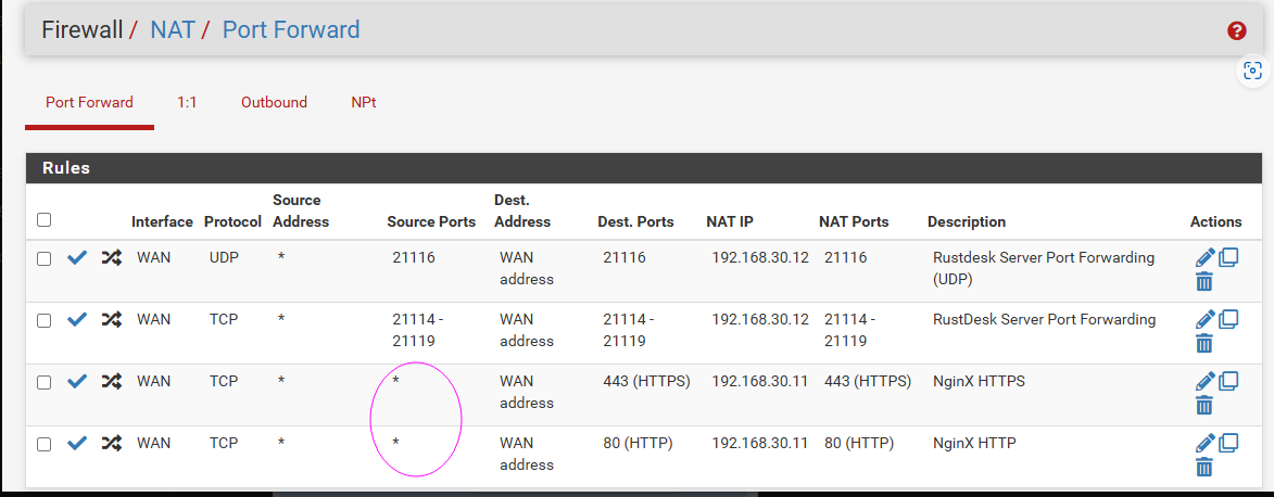

Did you set the source port to any in your port forward rules? That is your issue.
The Rustdesk ones yes but for NginX proxy manager, when I set these to 443 and 80 resopectively, I could not reach any of my sites listed in NginX
That doesn’t make any sense. The source ports will always be random. It’s the destination that matters. This is why you cannot reach rust desk.
I hear you but the Websites are working and Rustdesk not. I will pull it apart in the next few weeks and relook at things… I will also do some reading on port forwarding rule :slight_smile: Thanks for you direction and patience. I will update once I have worked out what I am doing … or rather once I understand this properly :slight_smile:
