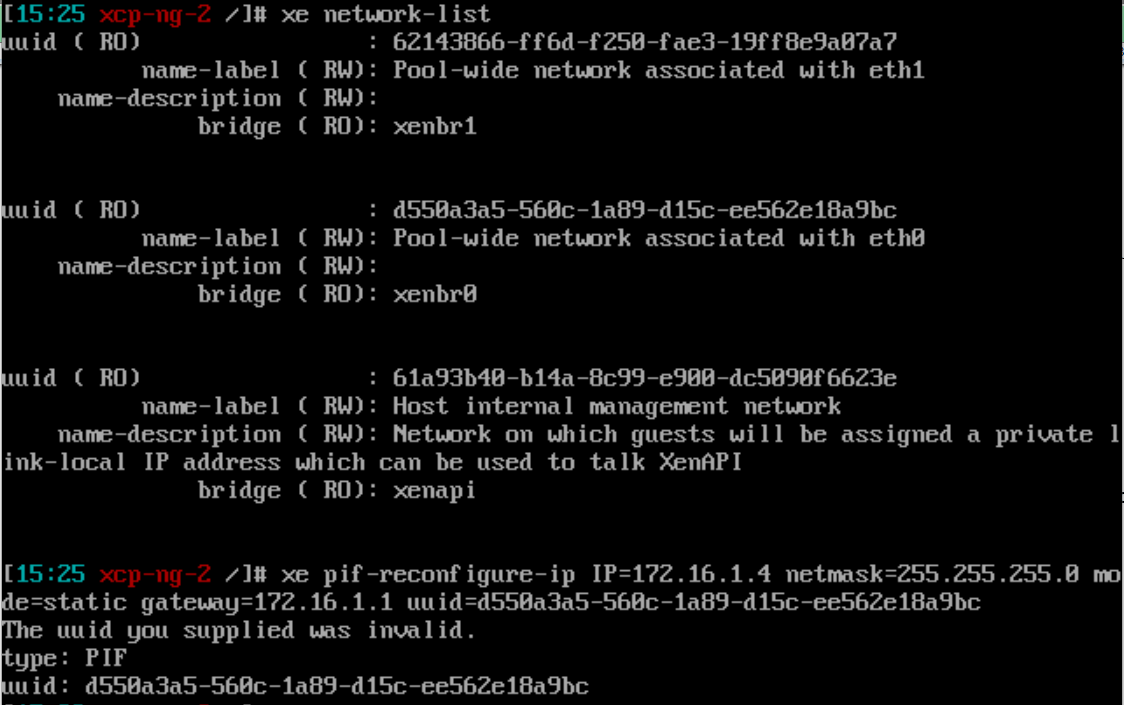

I used xe network-list to see the UUIDs. I then used the following command:
xe pif-reconfigure-ip IP=172.16.1.4 netmask=255.255.255.0 mode=static gateway=172.16.1.1 DNS=172.16.1.1 uuid=< uuid>
…I typed in the uuid from the xe network-list command for .
However, I get an error message that says “The uuid you supplied was invalid.”. But I checked and double-checked that I typed in the proper UUID from the xe network-list command. Why is it telling me the UUID is wrong? How do I accomplish setting the IP configuration for the second adapter from within XCP-ng?

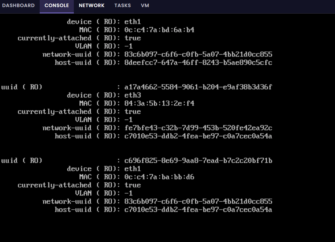

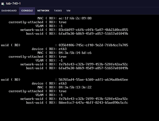

When I looked via XO-Lite, I got the same network UUID as show lower in the pif-list command (a17a4662-5584-9061-b204-e9af38b3d36f) but the UUID ( RO) is different.
After that, I’ve never tried to set up networking via CLI, and I should probably learn it (and will probably do so now).
Eth3 is the one I focused on because it is connected but not yet assigned to a network.
[edit] sorry, they are different UUID between XO-Lite and pif-list.
something funny, two different lists in my pif-list command, here’s the one I was looking at.
What command are you using? Was it from within the Local Command Shell inside XCP-ng? I’m not seeing the same type of results. I’m attaching a screenshot of the commands I used and their output.
I did xe pif-list to get the info above. Yes console but through XO-Lite because I’m in another room and it’s easy that way.
As you can see, I’m still getting uuid is invalid. What’s more, the uuid given in XO for the given interface is different for some reason than the one listed with xe pif-list on the host itself - and also is invalid. How do I find the valid uuid to use? Am I doing this wrong? Are there different commands that should be used to configure the second adapter?
Just figured out the issue. When I rebooted, the uuid matched. Thanks for your help Greg_E.
