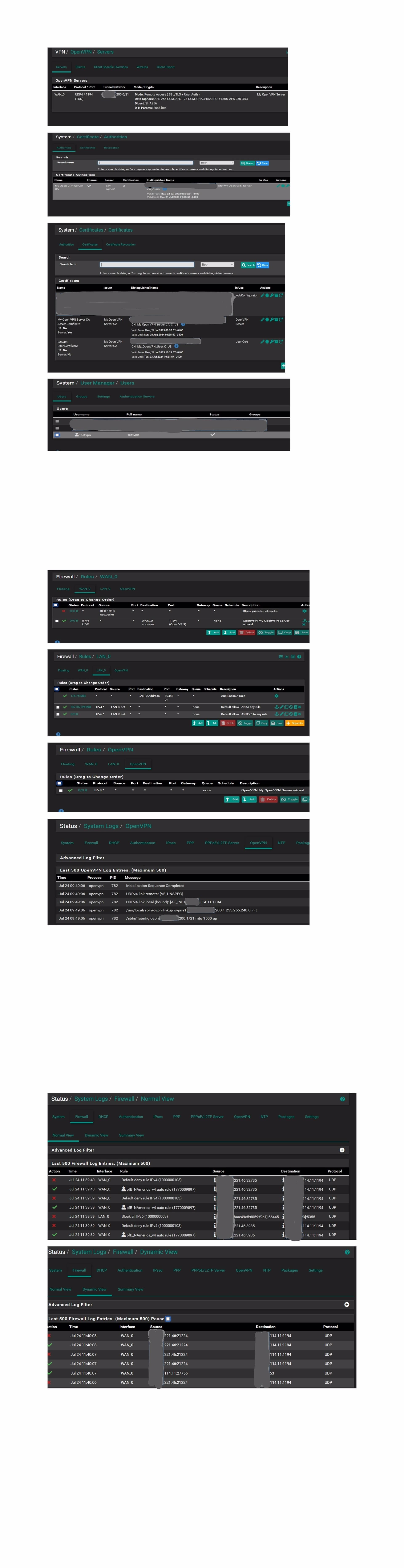

Ok I have gone through the video and did exactly what Tom did (I think) and I am unable to connect. So to summarize I setup the vpn server, I created 2 certs 1 for the server 1 for the user, I exported the client cert to an IOS device, entered username and password and the client never connected.

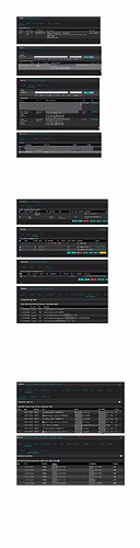

I pasted the system log output for fyi, this was captured at the time the ios client was trying to authenticate/connect. I have also included the various screenshots showing what has been created per the instructions.
.114.11 is the pfsense wan interface, the .200.x is the reserved ip range for vpn clients, .221.46 is the ip address for the ios device assigned by the provider and from which I am doing testing, I have the ddns service up and running and can ping from ios device.
Originally when setup I could not see the ios device ip in the logs, but when I pinged the ddns address from the ios device the ip began to appear in the log, this is wierd but it now shows up.
I feel like it is a firewall rule but from what I can tell the firewall is open to the open vpn port and wildcards should allow the traffic to pass. Maybe I have been looking at this too long and I cant see the problem or solution.

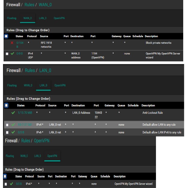

The rules on the WAN perhaps swap them round, not sure if that will work, but I tend to have allow what I want rules followed by block everything else.

Hi Neogrid appreciate the reply. I have not manually setup any NAT rules, everything is pretty much as it was when first installing PFS or OpenVPN in that respect. I have included screenshots of the FW rules which may provide some insight. Apologies for the format, the forum wont allow me to post more than one image per reply so I have to try and squeeze everything in on one slide. My ultimate objective is to access the network via VPN regardless of device type or ip address (obviously) as long as the ssl/tls and user authentication match. Let me know if you have any other questions or insight.

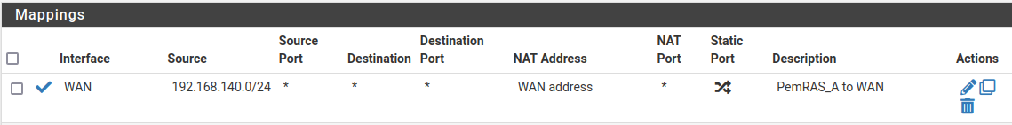

I’ve not used the wizard myself, however, you’ll need to have a NAT rule for the openVPN to WAN translation.

The source is the tunnel IP
