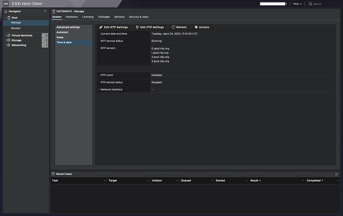

I have a VMware ESXi 8.0.0 server on which I have 2 Windows Server 2022 VMs: a domain controller and an RDS.
I noticed that the date and time of my 2 Windows Server VMs were moving forward a few minutes.

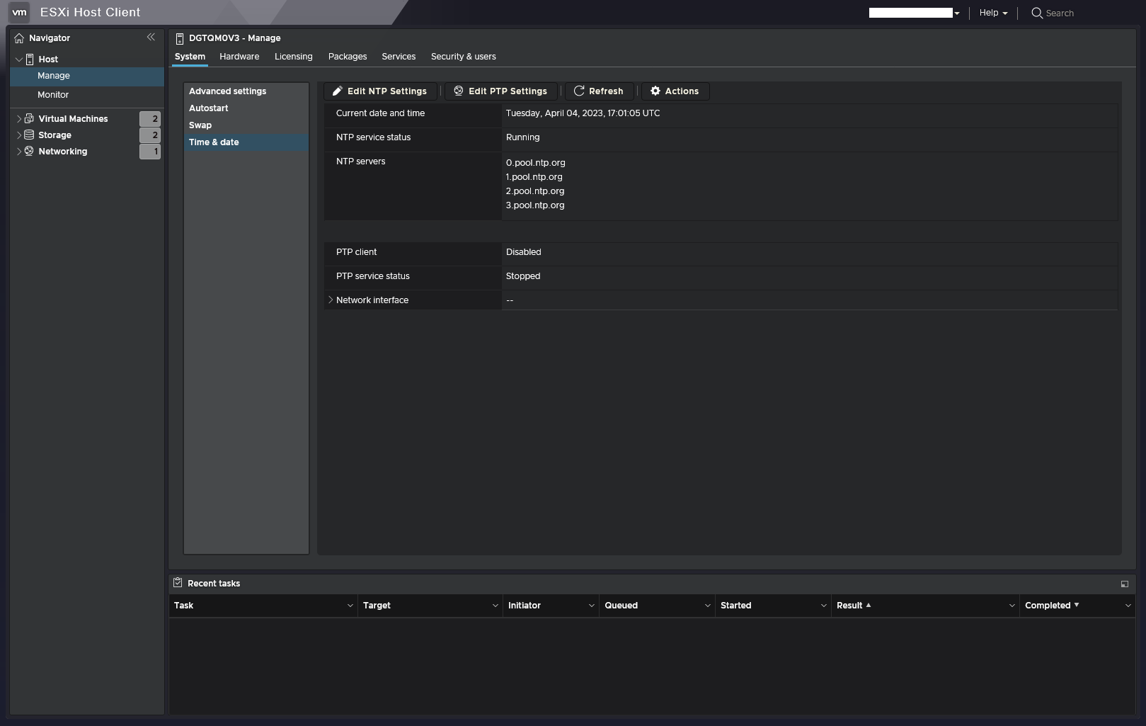

So via the ESXi Host Client web interface, I started the ntpd service and configured the NTP client in Host > Manage > System > Time & date.
After some time, the clock of my VMs was updated. I don’t know how, as VMware Tools aren’t installed (yet) on the domain controller.
Now the minutes are synchronized.
But the clock of my VMs is one hour behind.

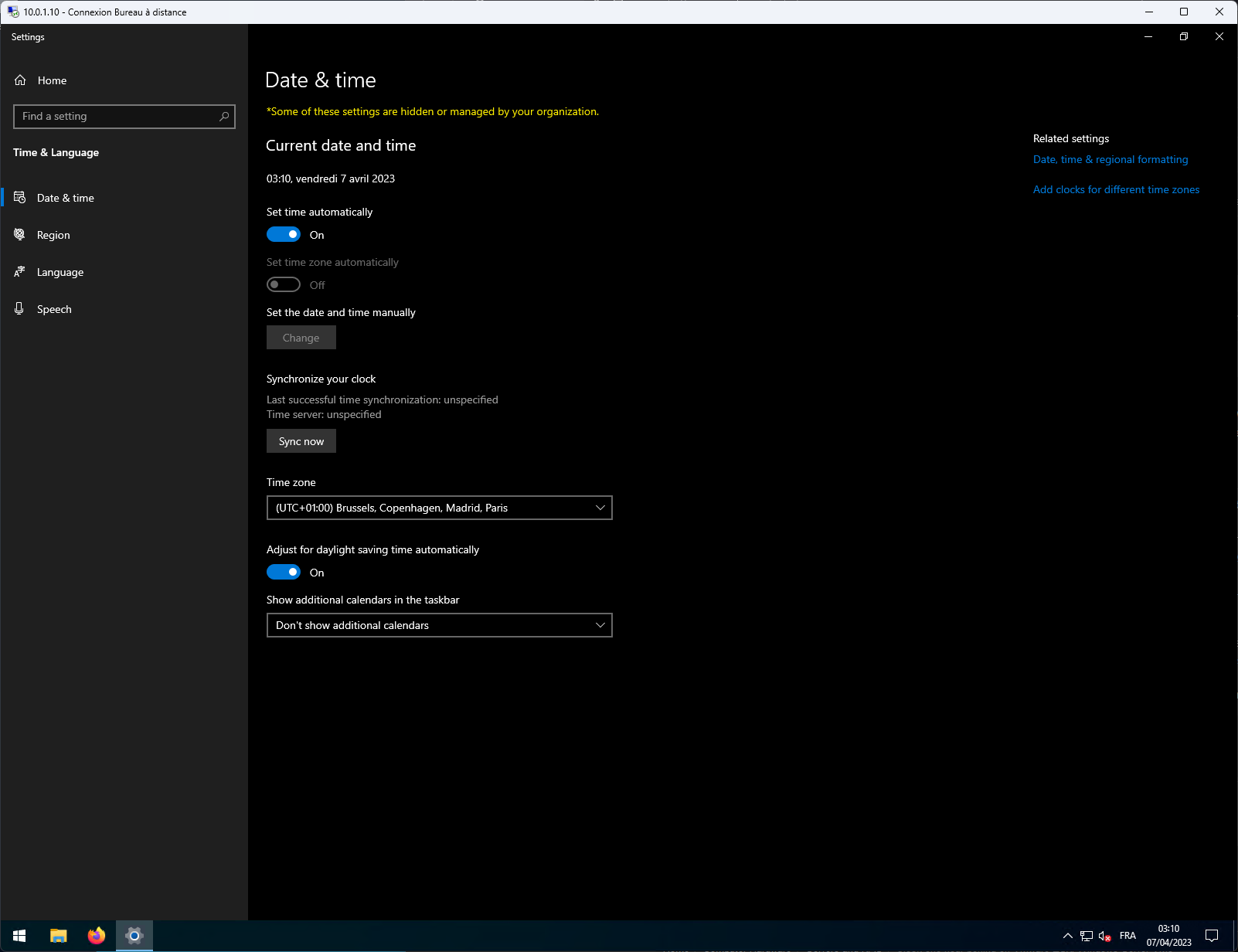

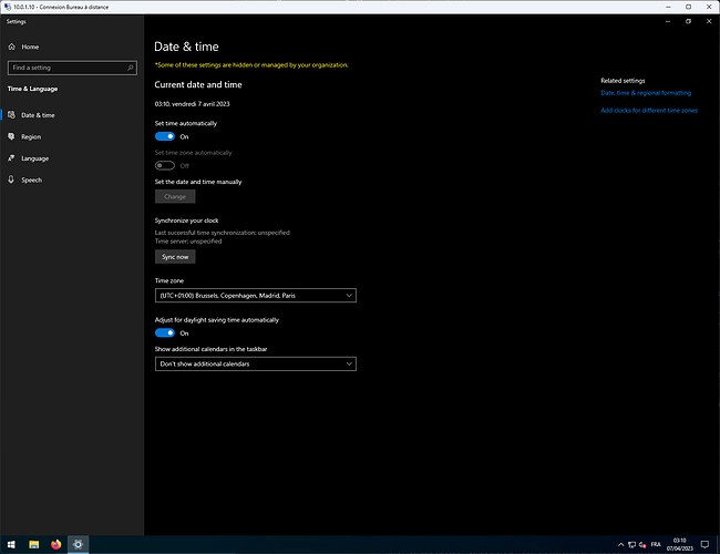

I’ve installed VMware Tools and both my VMs and I have enabled Edit > VM Options > VMware Tools > Synchronize guest time with host for both VMs in ESXi host web interface.
Now on my DC server, in Windows settings > Time & Language > Date & time, “Set time automatically” is enabled (it was previously greyed out), and “Last successful time synchronization” and “Time server” both show “unspecified”, instead of “Free-running system clock” for the latter. Is it expected behavior?
It’s even weirder on my RDS server: the “Time server” is now time.windows.com, instead of dc1..net. I have installed the VMware Tools and rebooted, but I haven’t changed anything else myself. What happened?

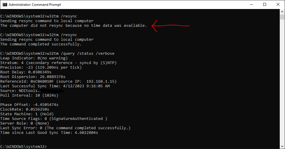

if you use w32tm /query /status /verbose will show you.
But your clients may or may not update very often, I have constant problems getting time sync from the domain controllers. Windows Time seems to work with a mind of its own, even when you set things up properly it doesn’t always keep good time. My clients normally stay within about a minute, that’s the closest I can get them to stay. This computer was last synced some 3000 seconds ago and failed several resync commands.
Finally got it to sync to one of my DC.
Oh, I had tried w32tm /query /status /verbose, but I was looking for a line starting with “Reliable”, I didn’t read carefully enough!
Then I thank you for your explanations and I will try to set up my DC as a reliable NTP server and the other computers as their NTP clients.
