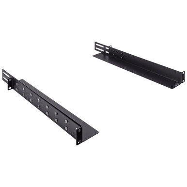

22 inches is a little shallow, I’m seeing used servers are mostly needing at least a 26 inch deep rack if you are going to use the correct rack rails for the equipment. That said, my lab is sitting on shelves, I think this is the pair I bought
They seem to be fine on my 1u servers though things slide around a bit when connecting cables. Production servers get proper rack sliding rails.
They also have decent looking shelves that are way cheaper than Middle Atlantic.

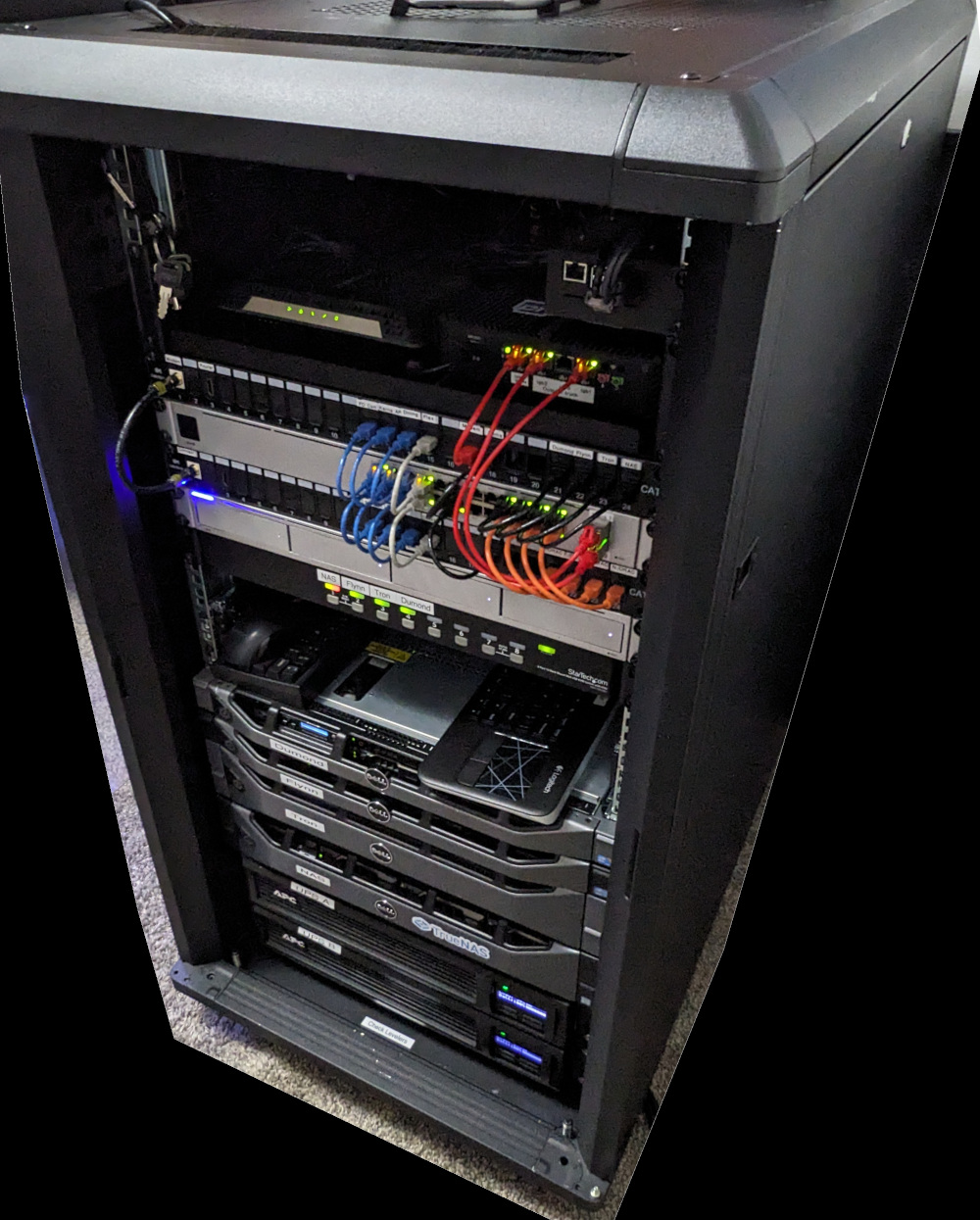

Get what you can afford now. There’s no need to blow your budget on the rack when I’m sure you have plenty of more interesting gear on your wish list. But of course having room to expand is helpful. I just used wire shelving for the longest time until I stumbled across a very nice 22U fully enclosed cabinet at an FSU surplus auction.
Also, as your homelab grows, heat production (and electricity usage) will becoming more pressing issues. As my server stack has grown I’ve ended up taking the front and back doors off to help with air flow.
I’ve enjoyed building and “re-building” my stack over time. Blinkenlights make me smile. :smiley:

Sounds like you got a good deal…my 22U rack is surprisingly similar. :wink:
Feeling some serious home lab envy here :laughing:. That looks great.
