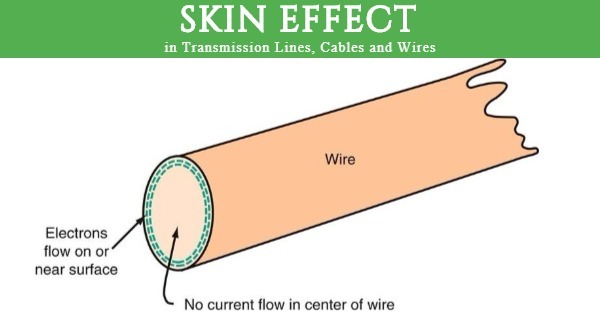

CCA relies on the “skin effect” for high frequency signals
This works fairly well for Radio Frequency needs, in the past many UHF transmitters used copper pipe for the center conductor because it worked as well or better than solid copper due to skin effect (and a lot lighter and cheaper). CCA relies on this to work “well”, but for POE you are now into the aluminum. Aluminum can be OK, but it can also be more brittle and it certainly doesn’t conduct as well as copper or silver. It’s cheap and for many things it works, but not my preference at all for signals I need to make it the first time they are sent. I think CCA cables might also have a shorter run distance over “pure” copper, you’d have to check the specification.
