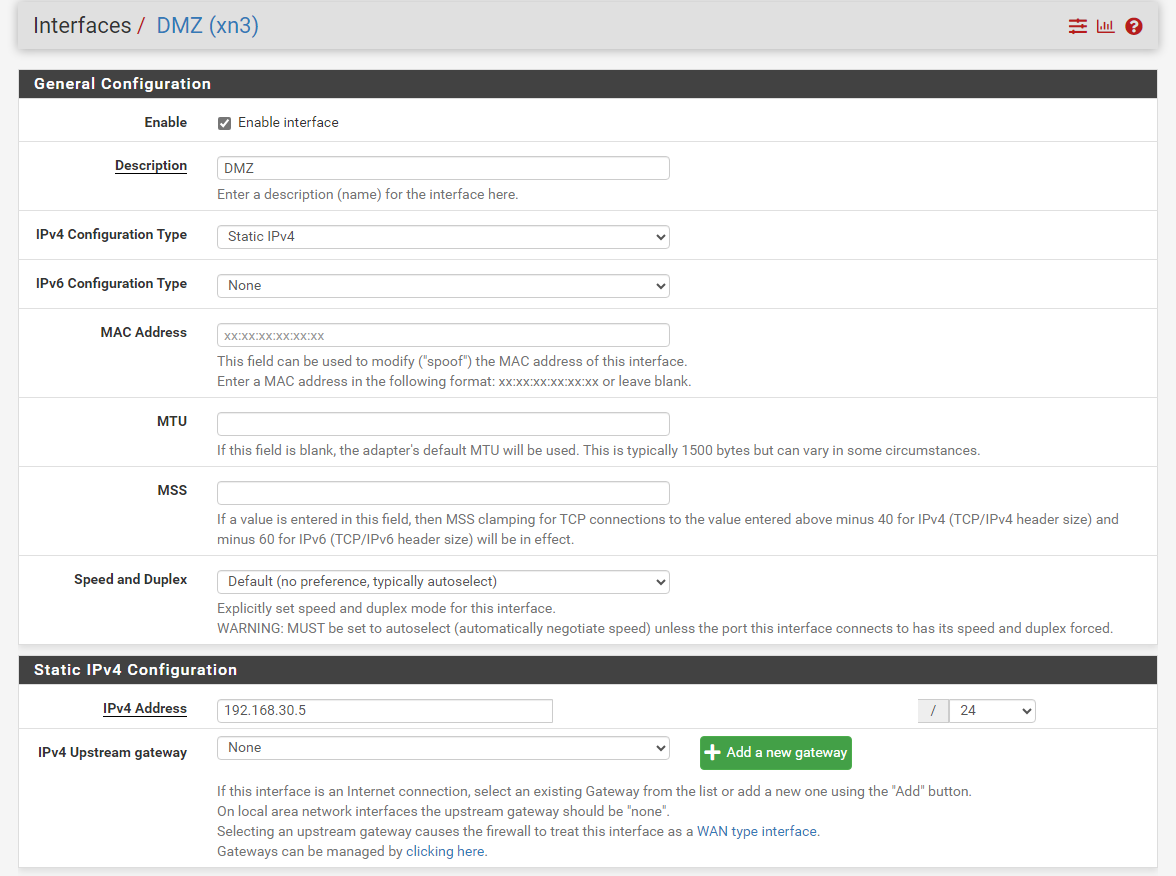

I have added a new interface (called DMZ for now). Except for the IP address, it is identical to the LAN interface.

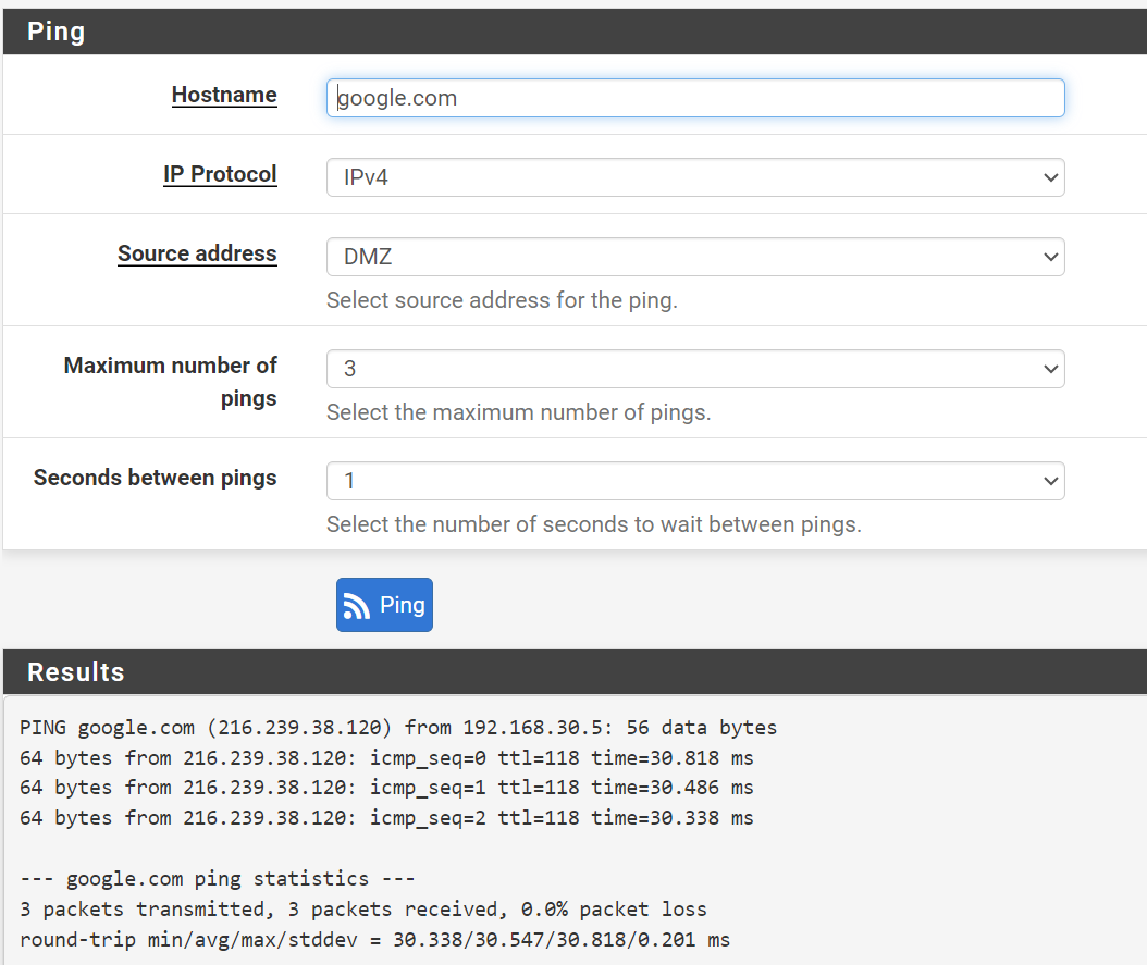

I can ping a url from the pFsense diagnostic page

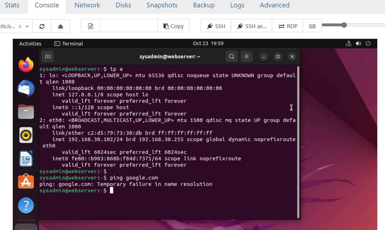

But not from a VM
The VM gets the correct IP so that appears to be correct. Is there possibly something that needs to be set on Xen Orchestra?

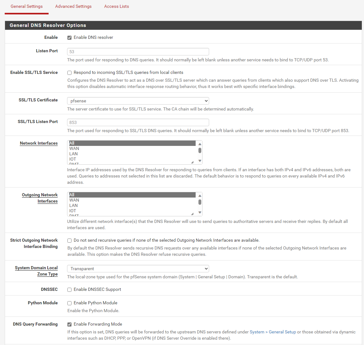

I’m guessing you didn’t alter the DHCP configuration, so the firewall’s interface address in that network is used. In the DNS resolver settings, if the listen interface isn’t set to any, you have to select the DMZ interface.
It looks all correct for me; but obviously not :wink:
Resolver

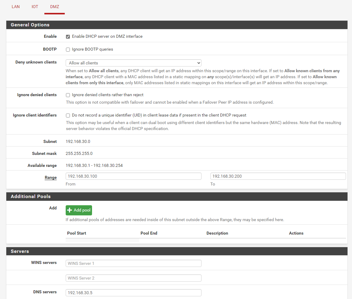

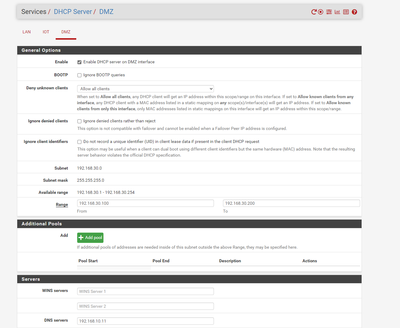

DHCP
192.168.10.11 is an IP address of the firewall?
Also, can you verify with resolvectl status that your machine uses the correct DNS server?
No, it is for Pi-Hole but it works on the lan interface. I have also tried leaving it blank in the DHCP settings so that it uses pfsense.
Are you saying it doesn’t work when set the DNS to the DMZ interface IP?

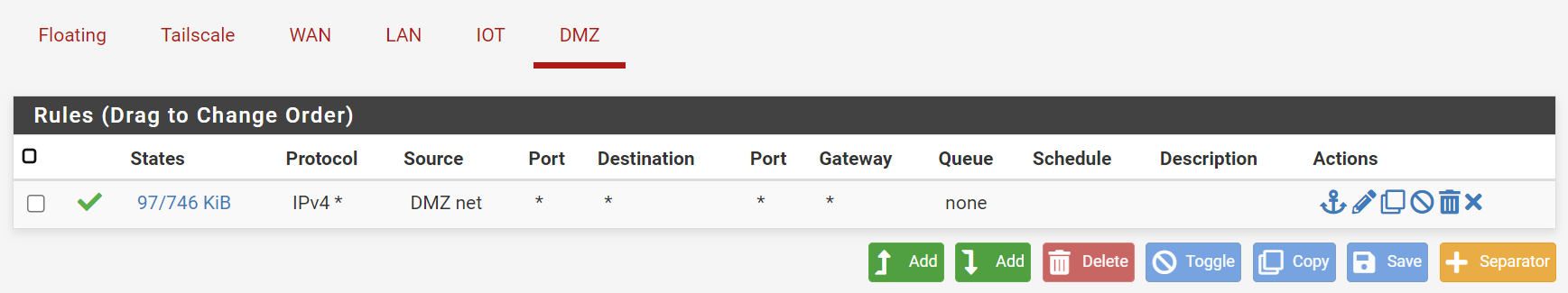

Alas not
Interface
DHCP
Client

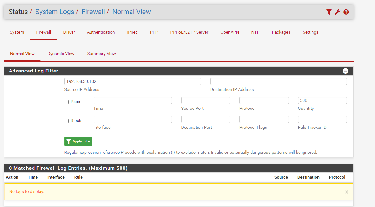

I think the next step is to look at the logs on pfsense and see where the block is happening or not happening.
I am guessing that I use the below and then filter on the ip of the client machine
I would have thought that there would be some traffic which makes me think the issue might be on the XEN side
What is strange is that I can ping an external ip but there is still nothing in the logs.
You need to ping with a hostname so you can see the DNS request being blocked.
The moment I enter something like ping google.com, I get “ping: google.com: Temporary failure in name resolution” and I can’t see anything in the logs; or I am looking in the wrong place
