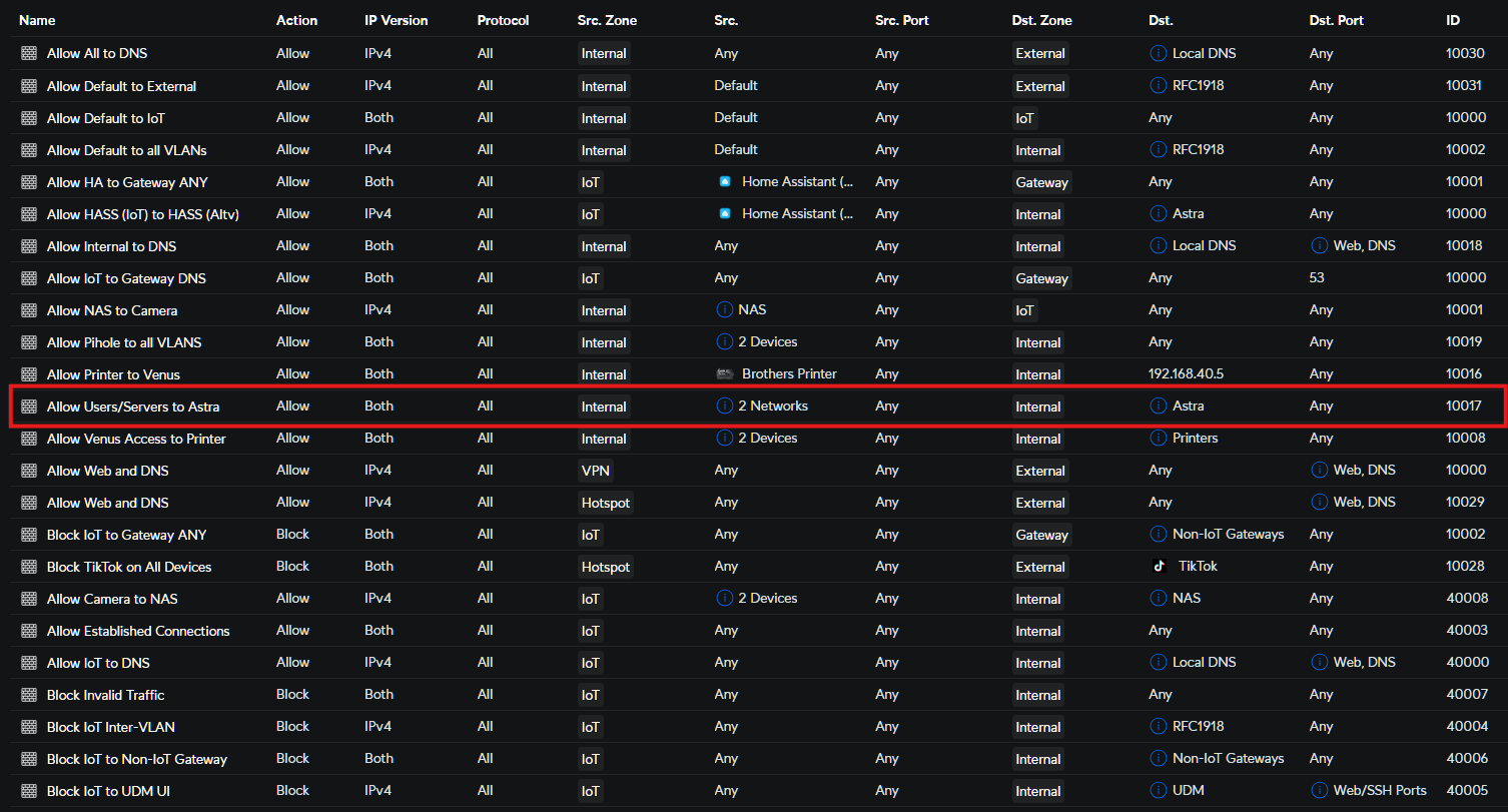

Please find the Unifi firewall rules below incase I’ve missed something obvious. The OS-level firewalls on the target machines are disabled.
I’ve not enabled any port isolation or other properties at the n/w level and the configuration is identical to other devices I’m able to ping.
I’d really appreciate any pointers. I’ve been scratching my head for far too long.
