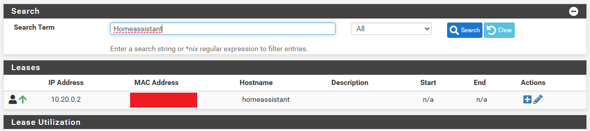

EDIT: This is the DHCP lease for Home Assistant. It has an address (assigned by Static IP Mapping in pfSense) of 10.20.0.2. When I attempt to browse to homeassistant.local:8123, it times out. When I attempt to browse to 10.20.0.2:8123, it connects with no issue.
