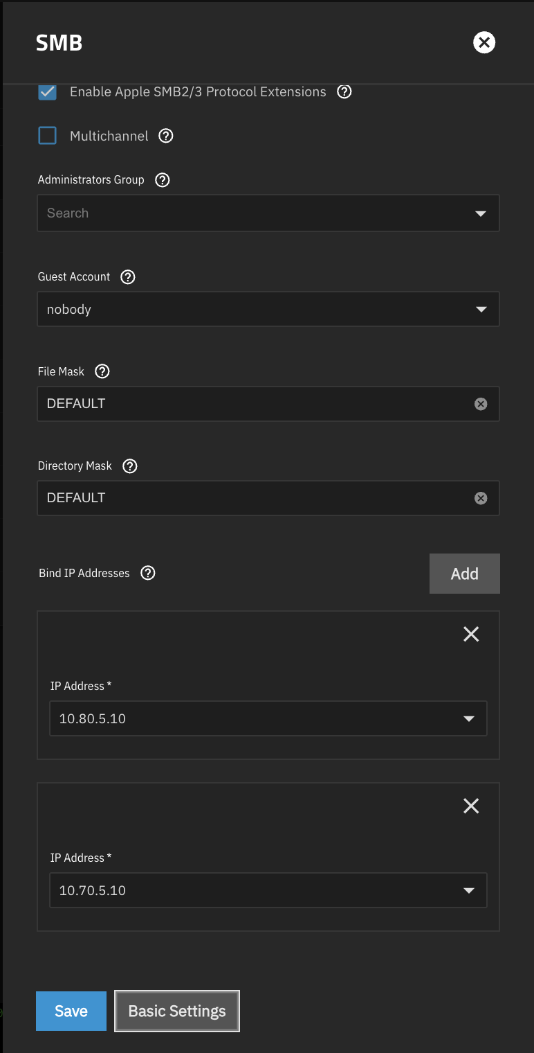

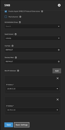

Of note, I do not have a NIC in truenas for my VPN subnet, so I dont have SMB bound to the VPN subnet (but, I had never had this, nor would I think it needs to be, should be able to access the SMB share regardless of which subnet I am on assuming traffic can pass). Seeing as I can SSH and ping everything else on the subnet except the SMB shares, I am lead to beleive my pfsense rules didn’t get borked…

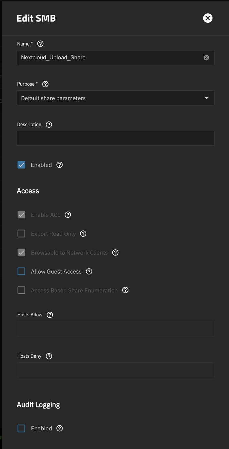

Check to see if you have any IP restrictions set for the SMB share that would only allow certain networks.
All I can find is a per SMB share setting:
I don’t see anything here that would make me believe this was causing the issue, but I can’t even ping the IP, so it seems like at an OS level truenas is regecting the connections.

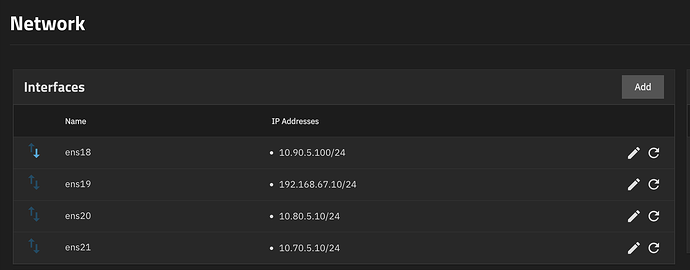

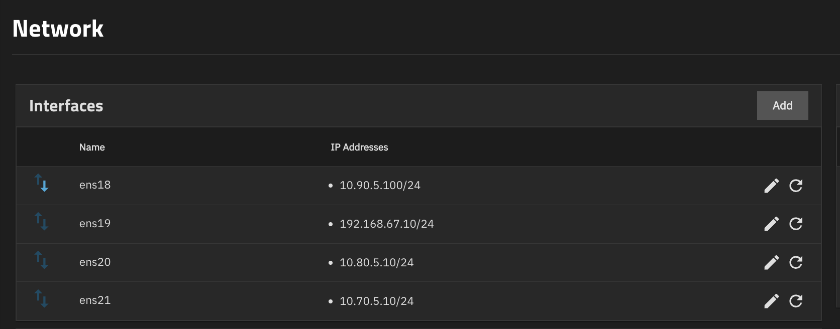

Looks at the network in use on TrueNAS, especially the ones for the docker containers, and see if there is an overlap in the network you are using.
Hmm, all I see is:
I don’t have any docker containers running, and from my googleing it looks like docker on truenas is using the typical 172.17.0.0/16 subnet. My VPN subnet is 10.1.15.4/24 so no conflict there.
I am really at a loss as to what this could be.

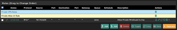

My Wireguard interface rules:
In my SMB settings, I do have SMB bound to these subnets, but to my understanding, that only means truenas is presenting SMB over these interfaces, not that it would ALSO be blocking incomming connection from subnets that are not equal to these, correct? If a device can communicate with either of these subnets via firewall rules, SMB should work… right?
